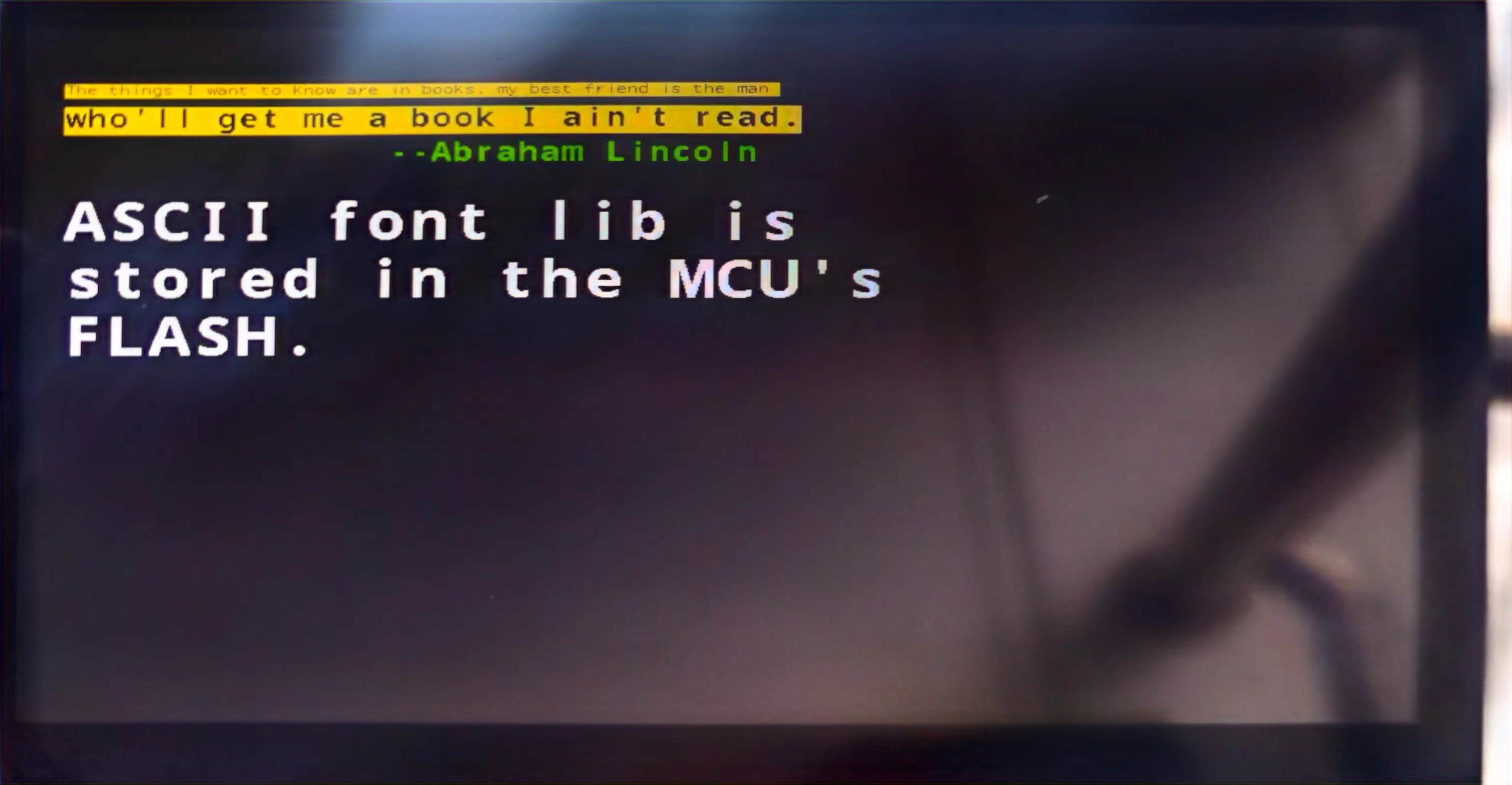

本文介绍用户自己生成的ASCII字库如何通过RA8889/RA8876显示到液晶屏上。
先上一张实例效果图:
再上程序代码:

  15.         /*RA8889初始化*/
  16.         RA8889_Initial();
  17.
  18.         /*清屏,填充黑色0x0*/
  19.         BTE_Solid_Fill(0,canvas_image_width,0,0,0x0,LCD_Width,LCD_Height);
  20.
  21.         /*MCU写入ASCII字符功能例程测试,不支持MCU_16bit_ColorDepth_24bpp_Mode_1 */
  22.         x=30;
  23.         y=50;
  24.         lcdPutString8x12(x,y,color65k_black,color65k_yellow,0,"The things I want to know are in books, my best friend is the man ");
  25.         lcdPutString16x24(x,y+20,color65k_black,color65k_yellow,0,"who'll get me a book I ain't read.");
  26.         lcdPutString16x24(x+16*14,y+50,color65k_green,color65k_yellow,1," --Abraham Lincoln ");
  27.         lcdPutString32x48(x,y+100,color65k_white,color65k_yellow,1,"ASCII font lib is ");
  28.         lcdPutString32x48(x,y+150,color65k_white,color65k_yellow,1,"stored in the MCU's");
  29.         lcdPutString32x48(x,y+200,color65k_white,color65k_yellow,1,"FLASH.");
  30.         while(1);
  31. }
程序流程图:
该方法是将制作好的ASCII字库放在MCU的FLASH中进行引用,字符数量为95个,编码区间0x20~0x7E,通过编码即可索引,并调用相应的数据,通过RA8889/RA8876描点显示出来。
