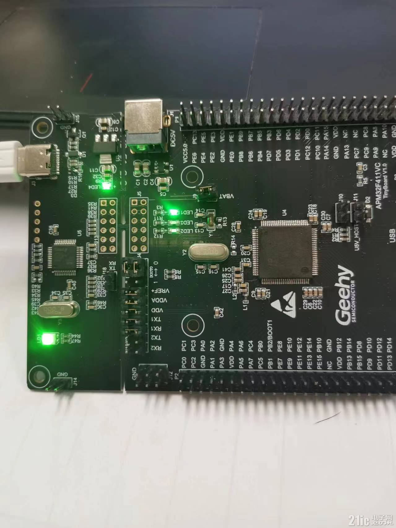

【APM32F411V Tiny Board测评】3、GPIO实现呼吸灯
1、程序说明
### 程序详细解释
```c
/* Includes */
#include "main.h"
#include "Board.h"

2、程序
  1. /* Includes */
  2. #include "main.h"
  3. #include "Board.h"
  4. /** @addtogroup Examples
  5.   @{
  6.   */
  7. /** @addtogroup GPIO_Toggle
  8.   @{
  9.   */
  10. /** @defgroup GPIO_Toggle_Macros Macros
  11.   @{
  12.   */
  13. #ifdef APM32F411
  14. #define APM_LEDInit    APM_TINY_LEDInit
  15. #define APM_LEDOn      APM_TINY_LEDOn
  16. #define APM_LEDOff     APM_TINY_LEDOff
  17. #else
  18. #define APM_LEDInit    APM_MINI_LEDInit
  19. #define APM_LEDOn      APM_MINI_LEDOn
  20. #define APM_LEDOff     APM_MINI_LEDOff
  21. #endif
  22. /**@} end of group GPIO_Toggle_Macros */
  23. /** @defgroup GPIO_Toggle_Functions Functions
  24.   @{
  25.   */
  26. /*!
  27. * @brief     Main program
  28. *
  29. * @param     None
  30. *
  31. * @retval    None
  32. */
  33. int main(void)
  34. {
  35.     int delay;
  36.     int step = 1;
  37.     int max_delay = 1000;
  38.     int min_delay = 1;
  39.     APM_LEDInit(LED2);
  40.     /* Init delay function */
  41.     Delay_Init();
  42.     while (1)
  43.     {
  44.         // Increase brightness
  45.         for (delay = min_delay; delay <= max_delay; delay += step)
  46.         {
  47.             APM_LEDOn(LED2);
  48.             Delay_us(delay);
  49.             APM_LEDOff(LED2);
  50.             Delay_us(max_delay - delay);
  51.         }
  52.         // Decrease brightness
  53.         for (delay = max_delay; delay >= min_delay; delay -= step)
  54.         {
  55.             APM_LEDOn(LED2);
  56.             Delay_us(delay);
  57.             APM_LEDOff(LED2);
  58.             Delay_us(max_delay - delay);
  59.         }
  60.     }
  61. }
  62. /**@} end of group GPIO_Toggle_Functions */
  63. /**@} end of group GPIO_Toggle */
  64. /**@} end of group Examples */
3、效果
