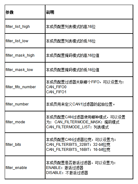

外设配置如代码清单CAN外设配置所示,在GD32全系列MCU中CAN外设的配置基本相同。GD32标准库提供了CAN初始化结构体及初始化函数来配置CAN外设,其初始化结构体说明如下表CAN参数初始化结构体说明列表和CAN过滤器初始化结构体说明列表所示。需要注意的是本例程需要用到两个开发板,一个发送,一个接收,这可以通过打开宏定义CAN_RECEIVE或CAN_TRANSMIT来决定当前是接收还是发送。

  24. /* initialize filter */
  25. can_filter_parameter.filter_number = 0;
  26. can_filter_parameter.filter_mode = CAN_FILTERMODE_MASK;
  27. can_filter_parameter.filter_bits = CAN_FILTERBITS_32BIT;
  28. can_filter_parameter.filter_list_high = 0x0000;
  29. can_filter_parameter.filter_list_low = 0x0000;
  30. can_filter_parameter.filter_mask_high = 0x0000;
  31. can_filter_parameter.filter_mask_low = 0x0000;
  32. can_filter_parameter.filter_fifo_number = CAN_FIFO0;
  33. can_filter_parameter.filter_enable = ENABLE;
  34. can_filter_init(&can_filter_parameter);

  89. can_filter_parameter.filter_number = 15;
  90. can_filter_parameter.filter_mode = CAN_FILTERMODE_MASK;
  91. can_filter_parameter.filter_bits = CAN_FILTERBITS_32BIT;
  92. can_filter_parameter.filter_list_high = 0x0000;
  93. can_filter_parameter.filter_list_low = 0x0000;
  94. can_filter_parameter.filter_mask_high = 0x0000;
  95. can_filter_parameter.filter_mask_low = 0x0000;
  96. can_filter_parameter.filter_fifo_number = CAN_FIFO0;
  97. can_filter_parameter.filter_enable = ENABLE;
  98. can_filter_init(&can_filter_parameter);

CAN 过滤器初始化结构体说明列表
