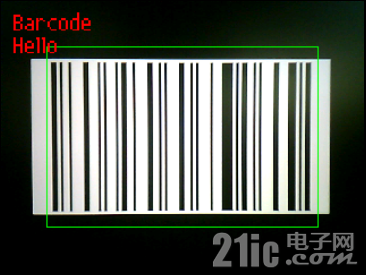

    elif type == 1:
        # 条形码识别
        roi = (img.width() // 2 - 120, img.height() // 2 - 80, 240, 160)
        gray = img.copy(roi).to_grayscale()
        img.draw_rectangle(roi, color=(0, 255, 0))
        barcodes = gray.find_barcodes((0, 0, gray.width(), gray.height()))
        if barcodes:
            img.draw_string(10, 30, barcodes[0].payload(), color=(255, 0, 0), scale=1.6)

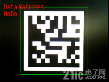

    elif type == 2:
        # DM码识别
        roi = (img.width() // 2 - 100, img.height() // 2 - 100, 200, 200)
        datamatrices = gray.find_datamatrices((0, 0, gray.width(), gray.height()))
        if datamatrices:
            img.draw_string(10, 30, datamatrices[0].payload(), color=(255, 0, 0), scale=1.6)

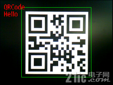

    elif type == 3:
        # 二维码识别
        qrcodes = gray.find_qrcodes((0, 0, gray.width(), gray.height()))
        if qrcodes:
            img.draw_string(10, 30, qrcodes[0].payload(), color=(255, 0, 0), scale=1.6)

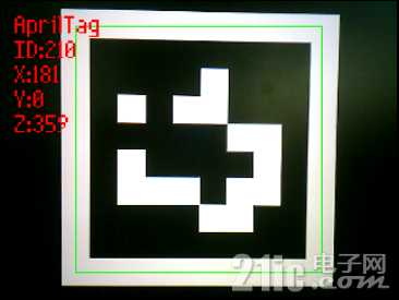

    elif type == 4:
        # AprilTag识别
        apriltags = gray.find_apriltags((0, 0, gray.width(), gray.height()), families=image.TAG36H11)
        if apriltags:
            def shot_degrees(axis, y, rotation):
                degrees = (180 * rotation) / math.pi
                img.draw_string(10, y, "{:s}:{:.0f}".format(axis, degrees), color=(255, 0, 0), scale=1.6)
            img.draw_string(10, 30, "ID:{:d}".format(apriltags[0].id()), color=(255, 0, 0), scale=1.6)
            shot_degrees("X", 50, apriltags[0].x_rotation())
            shot_degrees("Y", 70, apriltags[0].y_rotation())
            shot_degrees("Z", 90, apriltags[0].z_rotation())
    else:
        type = 0
    img.draw_string(10, 10, type_dict[type], color=(255, 0, 0), scale=1.6)
    lcd.display(img)
    gc.collect()

DNK210开发板连接CanMV IDE,点击CanMV IDE上的“开始(运行脚本)”按钮后,便能看到LCD上显示了摄像头输出的图像,并能看一个绿色的识别框,但将对应的码移入识别框后,能够看到LCD的左上角显示了识别到的结果,按下KEY0按键还能够切换识别码的种类,以识别不同种类的码,如下图所示:
38.4.1 条形码识别

38.4.2 DM码识别

38.4.3 二维码识别

38.4.4 AprilTag码识别
