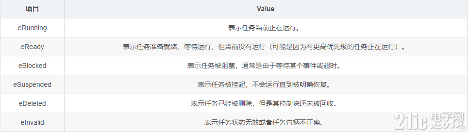

2.7 状态
void check_task_state(TaskHandle_t xTask)
    eTaskState state = eTaskGetState(xTask);
    switch(state) {
        case eRunning:
            printf("Task is Running\r\n");
            break;
        case eReady:
            printf("Task is Ready\r\n");
            break;
        case eBlocked:
            printf("Task is Blocked\r\n");
            break;
        case eSuspended:
            printf("Task is Suspended\r\n");
            break;
        case eDeleted:
            printf("Task is Deleted\r\n");
            break;
        case eInvalid:
            printf("Task State is Invalid\r\n");
            break;

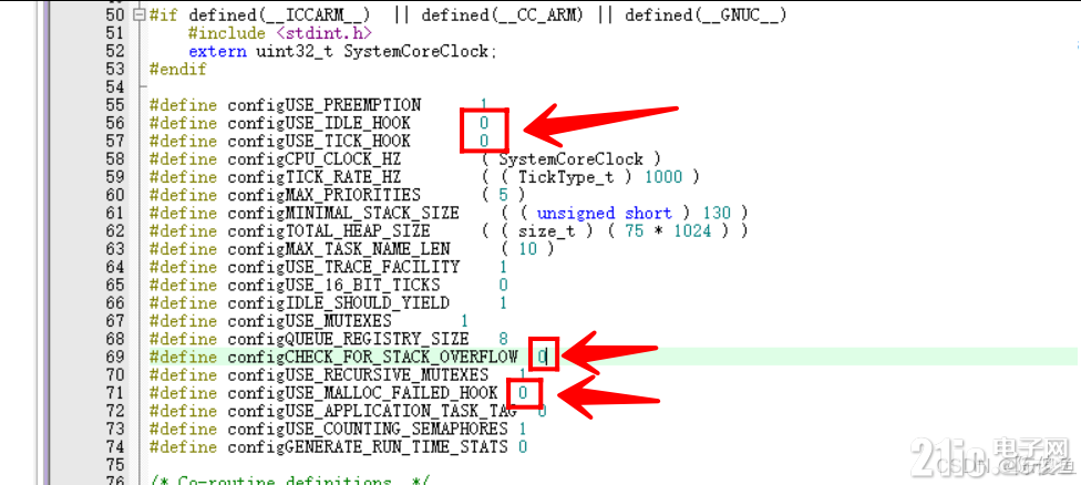

3. 编译报错
报错1: identifier “SystemCoreClock” is undefined
compiling port.c…
…\Driver\FreeRTOS\port\RVDS\ARM_CM4F\port.c(813): error: #20: identifier “SystemCoreClock” is undefined
portNVIC_SYSTICK_LOAD_REG = ( configSYSTICK_CLOCK_HZ / configTICK_RATE_HZ ) - 1UL;
解决办法
1:在FreeRTOSConfig.h中添加芯片头文件 #include “gd32f4xx.h”
2:将下面代码替换工程内的代码
#if defined(__ICCARM__)  || defined(__CC_ARM) || defined(__GNUC__)
    #include <stdint.h>
    extern uint32_t SystemCoreClock;
#endif

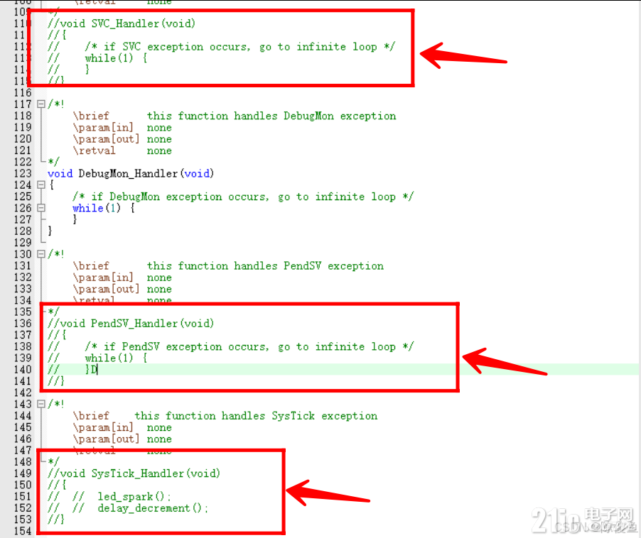

报错2:multiply defind
.\output\gd450_demo.axf: Error: L6200E: Symbol SVC_Handler multiply defined (by port.o and gd32f4xx_it.o).
.\output\gd450_demo.axf: Error: L6200E: Symbol PendSV_Handler multiply defined (by port.o and gd32f4xx_it.o).
.\output\gd450_demo.axf: Error: L6200E: Symbol SysTick_Handler multiply defined (by port.o and gd32f4xx_it.o).
解决办法
在gd32f4xx_it.c中注释掉相关代码
报错3:Undefined symbol
linking...
.\output\gd450_demo.axf: Error: L6218E: Undefined symbol vApplicationIdleHook (referred from tasks.o).
.\output\gd450_demo.axf: Error: L6218E: Undefined symbol vApplicationStackOverflowHook (referred from tasks.o).
.\output\gd450_demo.axf: Error: L6218E: Undefined symbol vApplicationTickHook (referred from tasks.o).
.\output\gd450_demo.axf: Error: L6218E: Undefined symbol vApplicationMallocFailedHook (referred from heap_4.o).
解决方法
在FreeRTOSConfig.h中更改对应宏定义
