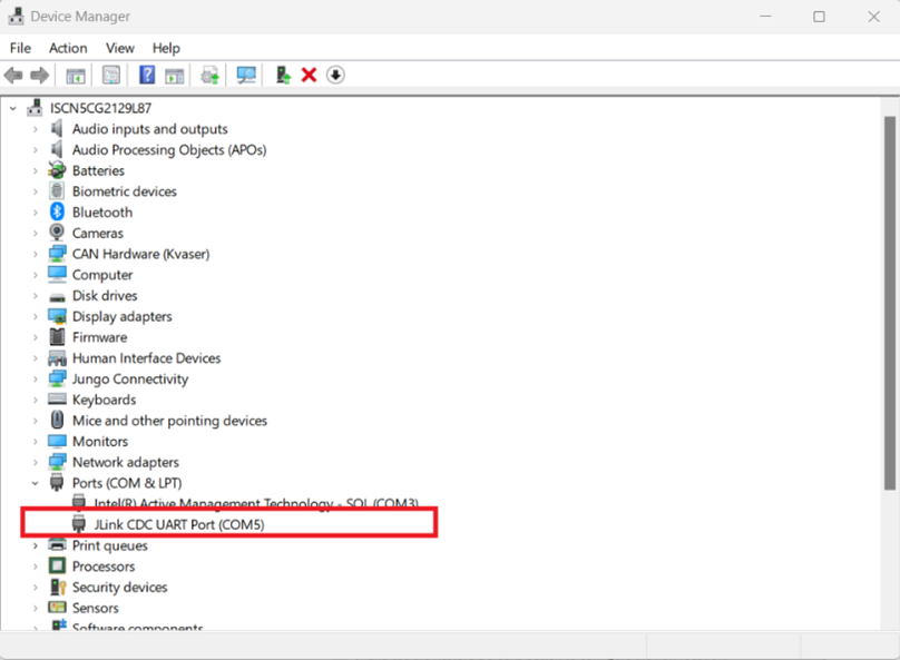

Step 2: Go to PC “Device Manager”, check whether the Debugger has been emulated in the Port (COM&LPT). If not, click [url=]here[/url] to download the latest J-link driver (check the “Install USB Driver for J-link (requires admin rights)”).

Figure 10: Checking ""Device Manager"" for driver installation
