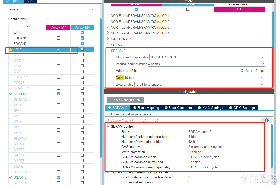

2、FMC配置
对应代码:
  1. void MX_FMC_Init(void)
  3.   /* USER CODE BEGIN FMC_Init 0 */
  4.   /* USER CODE END FMC_Init 0 */
  5.   FMC_SDRAM_TimingTypeDef SdramTiming = {0};
  6.   /* USER CODE BEGIN FMC_Init 1 */
  7.   /* USER CODE END FMC_Init 1 */
  8.   /** Perform the SDRAM2 memory initialization sequence
  9.   */
  10.   hsdram2.Instance = FMC_SDRAM_DEVICE;
  11.   /* hsdram2.Init */
  12.   hsdram2.Init.SDBank = FMC_SDRAM_BANK2;
  13.   hsdram2.Init.ColumnBitsNumber = FMC_SDRAM_COLUMN_BITS_NUM_8;
  14.   hsdram2.Init.RowBitsNumber = FMC_SDRAM_ROW_BITS_NUM_12;
  15.   hsdram2.Init.MemoryDataWidth = FMC_SDRAM_MEM_BUS_WIDTH_16;
  16.   hsdram2.Init.InternalBankNumber = FMC_SDRAM_INTERN_BANKS_NUM_4;
  17.   hsdram2.Init.CASLatency = FMC_SDRAM_CAS_LATENCY_2;
  18.   hsdram2.Init.WriteProtection = FMC_SDRAM_WRITE_PROTECTION_DISABLE;
  19.   hsdram2.Init.SDClockPeriod = FMC_SDRAM_CLOCK_PERIOD_2;
  20.   hsdram2.Init.ReadBurst = FMC_SDRAM_RBURST_ENABLE;
  21.   hsdram2.Init.ReadPipeDelay = FMC_SDRAM_RPIPE_DELAY_0;
  22.   /* SdramTiming */
  23.   SdramTiming.LoadToActiveDelay = 2;
  24.   SdramTiming.ExitSelfRefreshDelay = 6;
  25.   SdramTiming.SelfRefreshTime = 4;
  26.   SdramTiming.RowCycleDelay = 6;
  27.   SdramTiming.WriteRecoveryTime = 2;
  28.   SdramTiming.RPDelay = 2;
  29.   SdramTiming.RCDDelay = 2;
  30.   if (HAL_SDRAM_Init(&hsdram2, &SdramTiming) != HAL_OK)
  31.   {
  32.     Error_Handler( );
  33.   }
  34.   /* USER CODE BEGIN FMC_Init 2 */
  35.   /* USER CODE END FMC_Init 2 */
  36. }

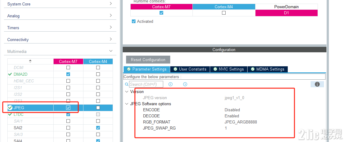

3、JPEG配置
对应代码:
  1. static void MX_JPEG_Init(void)
  3.   /* USER CODE BEGIN JPEG_Init 0 */
  4.   /* USER CODE END JPEG_Init 0 */
  5.   /* USER CODE BEGIN JPEG_Init 1 */
  6.   /* USER CODE END JPEG_Init 1 */
  7.   hjpeg.Instance = JPEG;
  8.   if (HAL_JPEG_Init(&hjpeg) != HAL_OK)
  9.   {
  10.     Error_Handler();
  11.   }
  12.   /* USER CODE BEGIN JPEG_Init 2 */
  13.   /* USER CODE END JPEG_Init 2 */
  14. }
