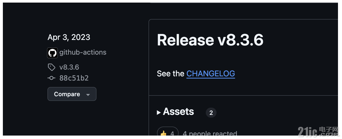

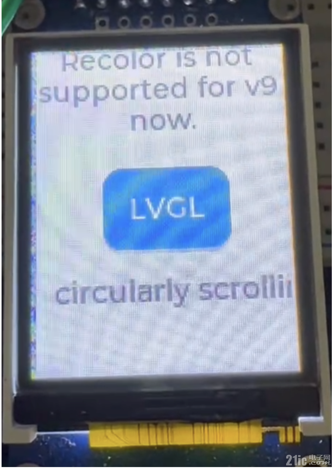

在这一篇中,我成功的创建了vscode的开发环境,在这个工程的基础之上,我进行LVGL的移植。
【源码下载】
官方网址为:https://aijishu.com/a/1060000000498034
为了配合以后的GUI—Guider的开发,我这里选择了8.3版本

5、在disp_flush函数中,添加画点函数,LcdDrawPoint(x,y,color_p->full);代码如下:
static void disp_flush(lv_disp_drv_t * disp_drv, const lv_area_t * area, lv_color_t * color_p)
    if(disp_flush_enabled) {
        /*The most simple case (but also the slowest) to put all pixels to the screen one-by-one*/
        int32_t x;
        int32_t y;
        for(y = area->y1; y <= area->y2; y++) {
            for(x = area->x1; x <= area->x2; x++) {
                /*Put a pixel to the display. For example:*/
                /*put_px(x, y, *color_p)*/
                color_p++;
    /*IMPORTANT!!!
     *Inform the graphics library that you are ready with the flushing*/
    lv_disp_flush_ready(disp_drv);

【编写测试代码】
在main.c中添加几个标签与按键的测试:
void LVGL_CentralButton(void)
    lv_obj_t *btn = lv_btn_create(lv_scr_act());
    lv_obj_align(btn, LV_ALIGN_CENTER, 0, 0);
    lv_obj_set_height(btn, 40);
    lv_obj_t *label;
    label = lv_label_create(btn);
    lv_obj_align(label, LV_ALIGN_CENTER, 0, 0);
    lv_label_set_text(label, "LVGL");
    static lv_style_t style_btn;
    lv_style_init(&style_btn);
    lv_style_set_radius(&style_btn, 10);
    lv_style_set_border_color(&style_btn, lv_color_white());
    lv_style_set_border_opa(&style_btn, LV_OPA_30);
    lv_obj_add_style(btn, &style_btn, LV_STATE_DEFAULT);
void lv_example_label_1(void)
    lv_obj_t * label1 = lv_label_create(lv_scr_act());
    lv_label_set_long_mode(label1, LV_LABEL_LONG_WRAP);     /*Break the long lines*/
    lv_label_set_text(label1, "Recolor is not supported for v9 now.");
    lv_obj_set_width(label1, 128);  /*Set smaller width to make the lines wrap*/
    lv_obj_set_style_text_align(label1, LV_TEXT_ALIGN_CENTER, 0);
    lv_obj_align(label1, LV_ALIGN_CENTER, 0, -60);
    lv_obj_t * label2 = lv_label_create(lv_scr_act());
    lv_label_set_long_mode(label2, LV_LABEL_LONG_SCROLL_CIRCULAR);     /*Circular scroll*/
    lv_obj_set_width(label2, 120);
    lv_label_set_text(label2, "It is a circularly scrolling text. ");
    lv_obj_align(label2, LV_ALIGN_CENTER, 0, 40);
void LVGL_Init(void)
    lv_init();                  // lvgl初始化,如果这个没有初始化,那么下面的初始化会崩溃
    lv_port_disp_init();        // 显示器初始化
    // lv_port_indev_init();       // 输入设备初始化(如果没有实现就注释掉)
    // lv_port_fs_init();          // 文件系统设备初始化(如果没有实现就注释掉)
然后在主程序中调用上面两个函数。
在while大循环中添加 lv_task_handler();
下载后面就可以看到应用效果了。
