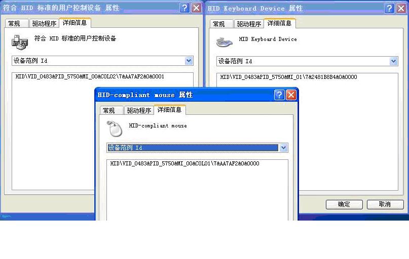

32777221 发表于 2010-6-5 13:03 | 显示全部楼层
多谢 lxyppc  对比了一下你的程序,顺利实现了 Keypad+Mouse 功能!!
主要修改了以下二个地方:
1):
if ((RequestNo == GET_DESCRIPTOR)
      && (Type_Recipient == (STANDARD_REQUEST | INTERFACE_RECIPIENT))
      //&& (pInformation->USBwIndex0 == 0))
    if (pInformation->USBwValue1 == REPORT_DESCRIPTOR)
      CopyRoutine = CustomHID_GetReportDescriptor;
    else if (pInformation->USBwValue1 == HID_DESCRIPTOR_TYPE)
      CopyRoutine = CustomHID_GetHIDDescriptor;
  } /* End of GET_DESCRIPTOR */
2);
u8 *CustomHID_GetReportDescriptor(u16 Length)
  u8 wIndex0 = pInformation->USBwIndex0;
  if (wIndex0 ==0)
   return Standard_GetDescriptorData(Length, &CustomHID_Hid_Mouse_Descriptor);
  else
   return Standard_GetDescriptorData(Length, &CustomHID_Hid_Keypad_Descriptor);
