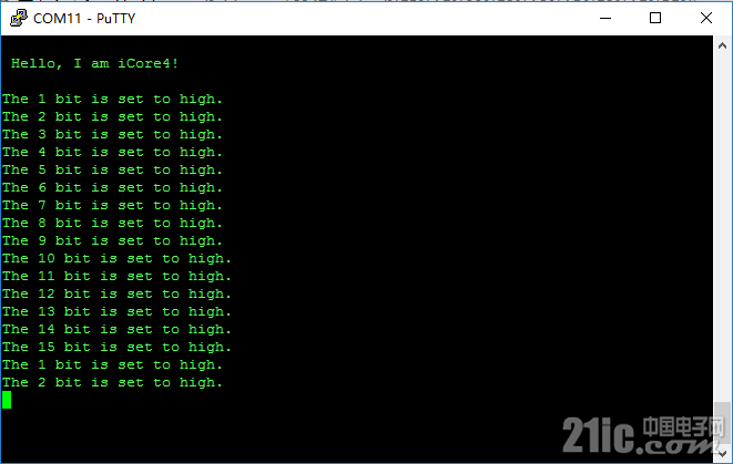

第二个 例子应用如下:
#include "..\include\main.h"
#include "..\include\led.h"
#include "..\include\system_clock.h"
#include "..\include\usart6.h"
#include "..\include\key.h"
#include "includes.h"
#include "stm32f7xx_hal.h"
#include <ctype.h>
#include <string.h>
#include <stdlib.h>
#include <stdio.h>
//------------------------- Define ------------------------//
#define START_TASK_PRIO           10
#define AppTask1_TASK_PRIO        9
#define AppTask2_TASK_PRIO        8
#define START_STK_SIZE            128
#define AppTask1_STK_SIZE                128
#define AppTask2_STK_SIZE                128
//------------------------ Variable -----------------------//
OS_STK START_TASK_STK[START_STK_SIZE];
OS_STK AppTask1_TASK_STK[AppTask1_STK_SIZE];
OS_STK AppTask2_TASK_STK[AppTask2_STK_SIZE];
OS_FLAG_GRP *TaskFlag;//定义一个信号量集
 楼主| wangjiahao88 发表于 2018-3-7 09:58 | 显示全部楼层
//------------------- Function Prototype ------------------//
void start_task(void *pdata);
void AppTask1_task(void *pdata);
void AppTask2_task(void *pdata);
//------------------------ Function -----------------------//
* Name                : main
* Description         : ---
* Author              : liu.
* History
* Rev                 : 0.00
* Date                : 07/12/2017
* create.
/*实验现象:
  打开串口工具putty.exe,按下按键ARM.KEY,终端显示信号量集的状态;松开按键,停止显示。
信号量的16位分别循环置1。
int main(void)
    system_clock.initialize();                               //系统时钟初始化
    led.initialize();                                        //LED初始化
    usart6.initialize(115200);                               //串口初始化
    key.initialize();
    usart6.printf("\x0c");                                   //清屏
    usart6.printf("\033[1;32;40m");                          //设置字体终端为绿色
    usart6.printf("\r\n Hello, I am iCore4!\r\n\r\n");
    LED_RED_ON;
    OSInit();
    //UCOS初始化
    OSTaskCreate(start_task,                                 //创建开始任务
                 (void*)0,                                   //任务参数
                 (OS_STK*)&START_TASK_STK[START_STK_SIZE-1], //任务堆栈
                 START_TASK_PRIO);                           //任务优先级
    OSStart();                                               //开启UCOS
 楼主| wangjiahao88 发表于 2018-3-7 10:47 | 显示全部楼层
* Name                : AppTask1_task
* Description         : ---
* Author              : liu.
* History
* Rev                 : 0.00
* Date                : 07/12/2017
* create.
    u8 err;
    int i = 0;
    while(1) {
        if(ARM_KEY_STATE == KEY_DOWN)
                        {                  //按键按下
            i++;
            if(i < OS_FLAGS_NBITS) {
                OSFlagPost(TaskFlag,i,OS_FLAG_SET,&err);     //设置第0位的信号为1
            } else {
                i=0;
        OSTimeDlyHMSM(0,0,0,500);                        //延时500ms
 楼主| wangjiahao88 发表于 2018-3-7 10:48 | 显示全部楼层
* Name                : AppTask2_task
* Description         : ---
* Author              : liu.
* History
* Rev                 : 0.00
* Date                : 07/12/2017
* create.
    u8 err;
    u16 flag;
    while(1) {
        flag = OSFlagQuery(TaskFlag,&err);                     //查询信号量集的状态
        if(flag != 0) {
            usart6.printf("The %d bit is set to high.\r\n",flag);
            OSFlagPost(TaskFlag,(OS_FLAGS)flag,OS_FLAG_CLR,&err);//信号置0
