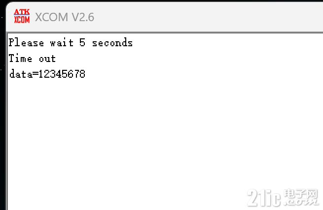

在SDK的RTC_Alarm例程中增加备份RAM的使用进行测试。
- uint32_t data ;
- int main(void)
- USART_Config_T usartConfigStruct;
- usartConfigStruct.baudRate = 115200;
- usartConfigStruct.hardwareFlow = USART_HARDWARE_FLOW_NONE;
- usartConfigStruct.mode = USART_MODE_TX;
- usartConfigStruct.parity = USART_PARITY_NONE;
- usartConfigStruct.stopBits = USART_STOP_BIT_1;
- usartConfigStruct.wordLength = USART_WORD_LEN_8B;
- APM_COMInit(COM1, &usartConfigStruct);
- APM_LEDInit(LED2);
- APM_LEDInit(LED3);
- APM_LEDOff(LED2);
- APM_LEDOff(LED3);
- RCM_EnableAPB1PeriphClock(RCM_APB1_PERIPH_PMU);
- /* Allow access to RTC */
- PMU_EnableBackupAccess();
- RCM_EnableAHB1PeriphClock(RCM_AHB1_PERIPH_BKPSRAM);
- /* Enable the LSI OSC */
- RCM_EnableLSI();
- /* Reset RTC*/
- RTC_Reset();
- /* Config RTC */
- RTC_Init();
- /* Config Alarm */
- RTC_AlarmsConfig();
- *(__IO uint32_t*)(BKPSRAM_BASE + 0x00) = 0x12345678;
- printf("Please wait 5 seconds\r\n");
- Delay(10000);
- /* Alarm Enable */
- RTC_EnableAlarmA();
- APM_LEDOn(LED2);
- /* wait until time out */
- while(RTC_ReadStatusFlag(RTC_FLAG_ALRAF)==RESET);
- printf("Time out\r\n");
- data = *(__IO uint32_t*)(BKPSRAM_BASE + 0x00);
- printf("data=%x\r\n",data);
- APM_LEDOff(LED2);
- while(1)
- APM_LEDToggle(LED3);
- Delay(0x4FFFFF);
测试结果:
