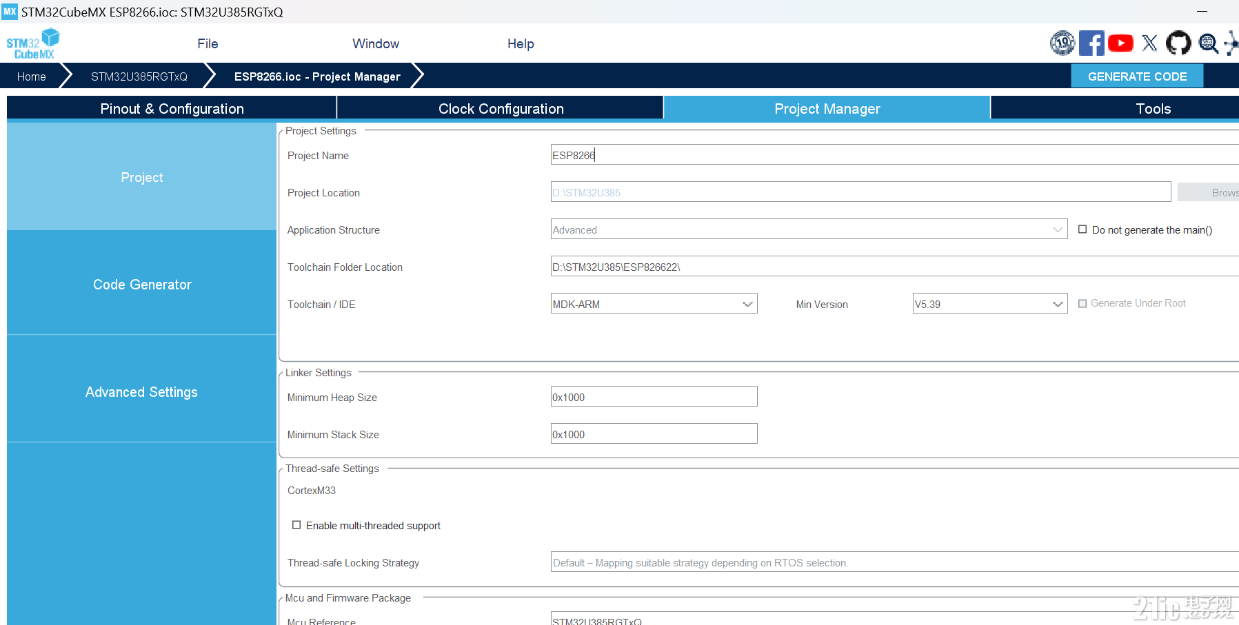

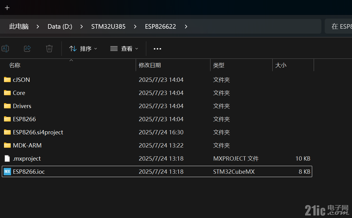

1.创建cubemx工程

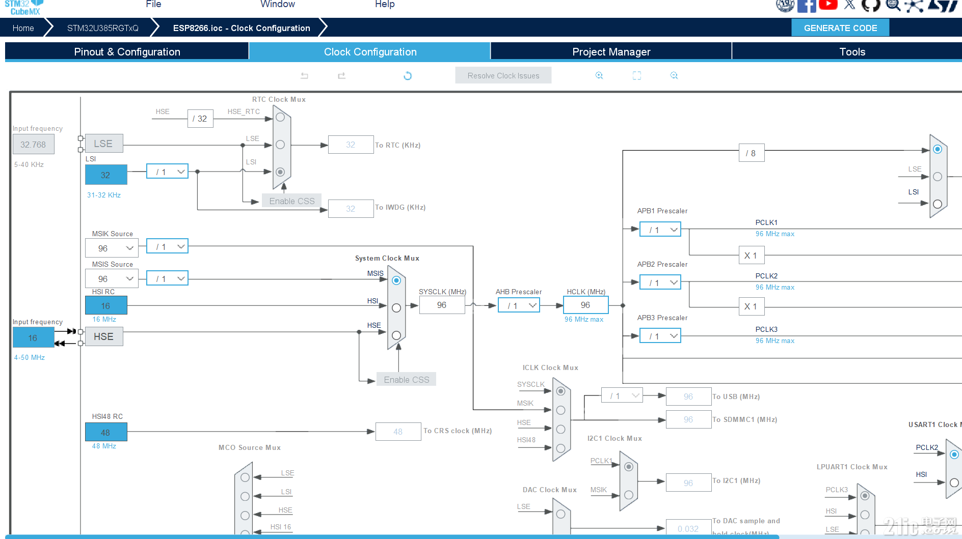

2.配置好时钟96MHZ

4.生成代码

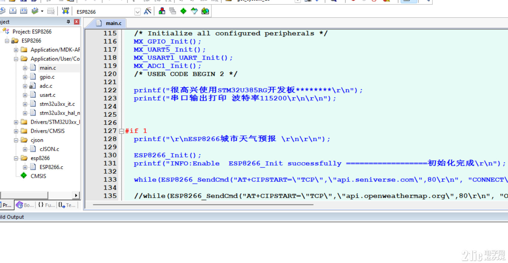

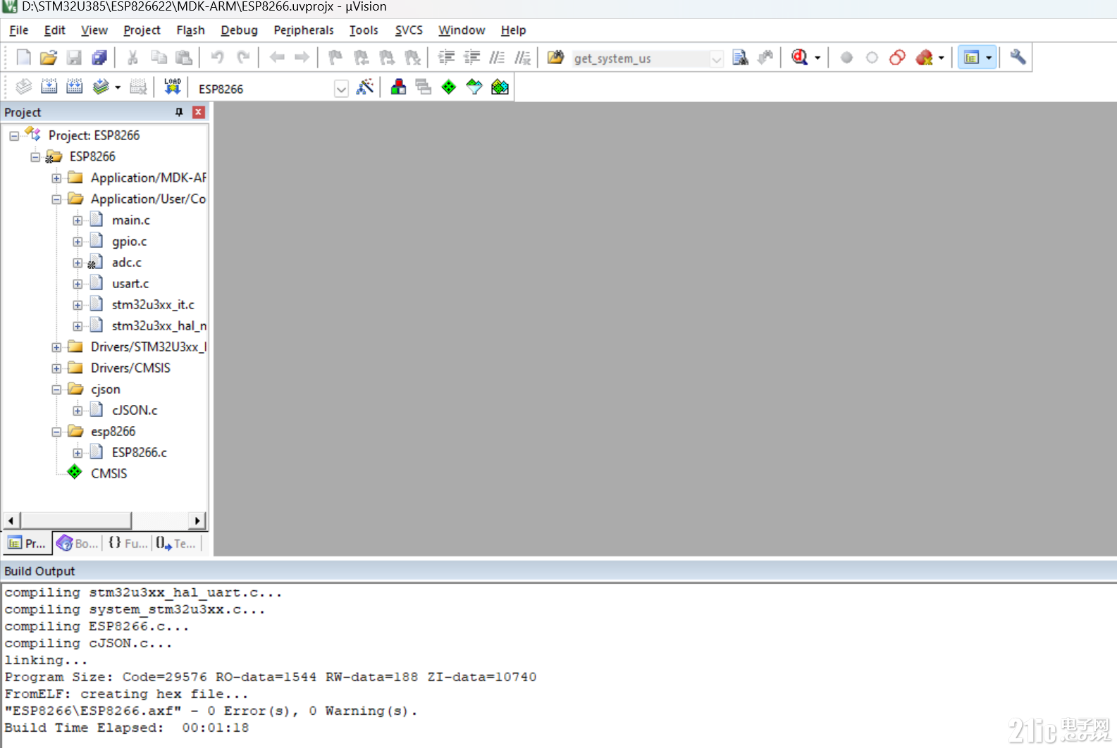

5.打开KEIL工程
6.修改核心代码

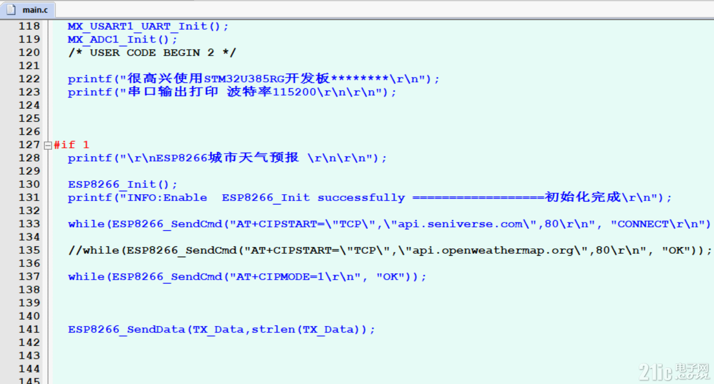

  /* USER CODE BEGIN 2 */
  printf("很高兴使用STM32U385RG开发板********\r\n");
  printf("串口输出打印 波特率115200\r\n\r\n");
#if 1
        printf("\r\nESP8266城市天气预报 \r\n\r\n");
        ESP8266_Init();
        printf("INFO:Enable  ESP8266_Init successfully ==================初始化完成\r\n");
        while(ESP8266_SendCmd("AT+CIPSTART=\"TCP\",\"api.seniverse.com\",80\r\n", "CONNECT\r\n"));
        //while(ESP8266_SendCmd("AT+CIPSTART=\"TCP\",\"api.openweathermap.org\",80\r\n", "OK"));
        while(ESP8266_SendCmd("AT+CIPMODE=1\r\n", "OK"));
        ESP8266_SendData(TX_Data,strlen(TX_Data));
        HAL_Delay(500);
        printf("%d\r\n",esp8266_cnt);
        printf("%d\r\n",strlen(esp8266_buf));
        printf("原始天气数据\r\n");
        printf("*****************************************************************************\r\n");
        printf("%s\r\n",esp8266_buf);

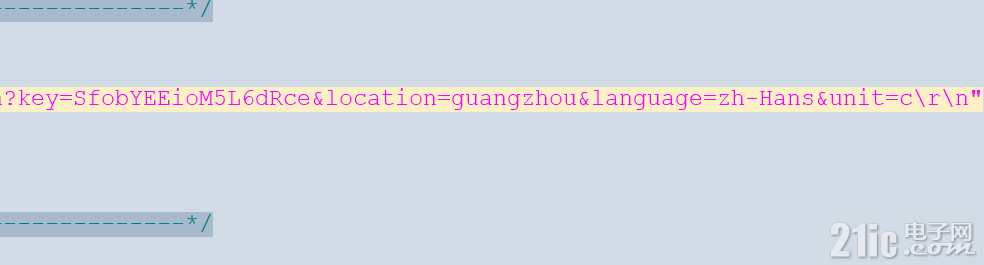

默认修改城市为广州
char TX_Data[]="GET https://api.seniverse.com/v3/weather/now.json?key=SfobYEEioM5L6dRce&location=guangzhou&language=zh-Hans&unit=c\r\n";
编译代码,烧录到STM32U385RG板子,

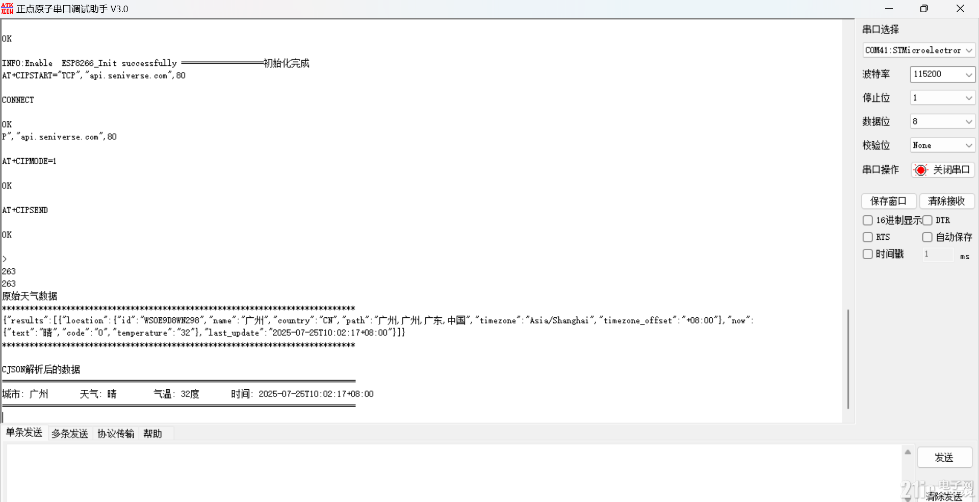

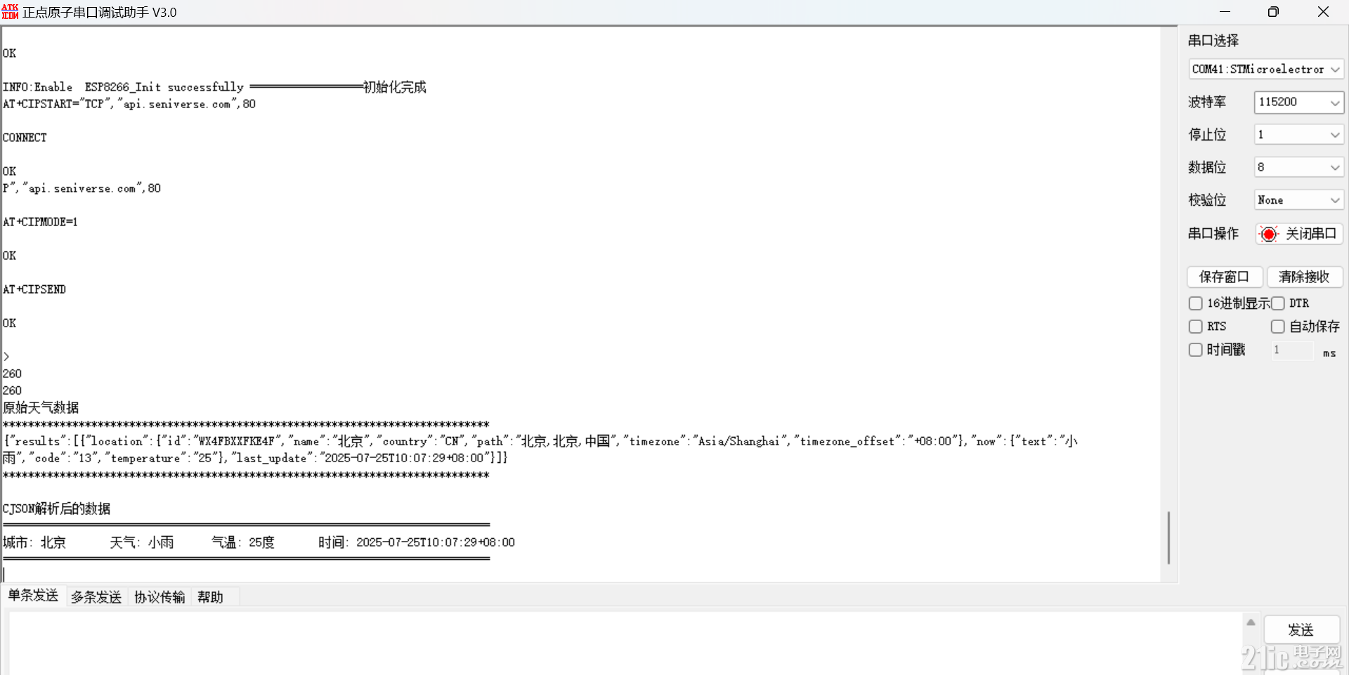

打开串口调试助手,查看打印数据
{"results":[{"location":{"id":"WS0E9D8WN298","name":"广州","country":"CN","path":"广州,广州,广东,中国","timezone":"Asia/Shanghai","timezone_offset":"+08:00"},"now":{"text":"晴","code":"0","temperature":"32"},"last_update":"2025-07-25T10:02:17+08:00"}]}
打开手机,查看广州天气预报
可以看到气温非常的准确

烧录到板子,查看串口助手
{"results":[{"location":{"id":"WX4FBXXFKE4F","name":"北京","country":"CN","path":"北京,北京,中国","timezone":"Asia/Shanghai","timezone_offset":"+08:00"},"now":{"text":"小雨","code":"13","temperature":"25"},"last_update":"2025-07-25T10:07:29+08:00"}]}

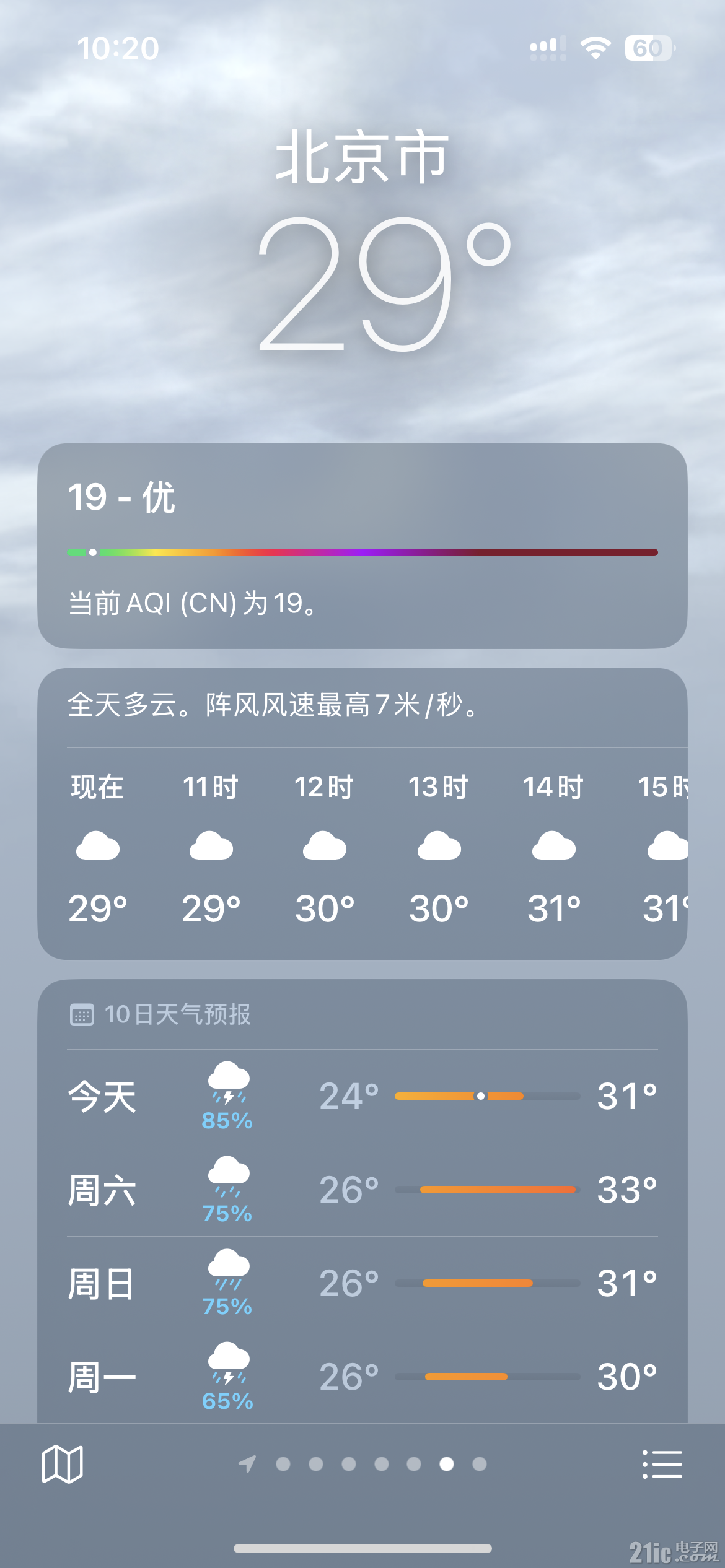

打开手机,查看北京天气预报
