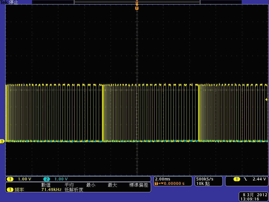

wallace_tsou 发表于 2015-2-2 10:16 | 显示全部楼层

wallace_tsou 发表于 2015-2-2 11:52 | 显示全部楼层
#include "core_cm3.h"
#include "FreeRTOS.h"
#include "task.h"
#include "queue.h"
#include <stdio.h>
void main()
    static void vLED1Task( void *pvParameters );
    static void vPulseTask( void *pvParameters );
    RCC_APB2PeriphClockCmd(RCC_APB2Periph_GPIOA, ENABLE);
    RCC_APB2PeriphClockCmd(RCC_APB2Periph_GPIOB, ENABLE);
    RCC_APB2PeriphClockCmd(RCC_APB2Periph_GPIOC, ENABLE);
    RCC_APB2PeriphClockCmd(RCC_APB2Periph_GPIOD, ENABLE);
    xTaskCreate( vLED1Task,  ( signed char * ) "LED1",  128, NULL, tskIDLE_PRIORITY + 1, NULL );
    xTaskCreate( vPulseTask, ( signed char * ) "PLUSE", 128, NULL, tskIDLE_PRIORITY + 2, NULL );
    vTaskStartScheduler();
    (void) pvParameters;
    GPIO_InitStructure.GPIO_Mode = GPIO_Mode_Out_PP;
    GPIO_InitStructure.GPIO_Pin = GPIO_Pin_15;
    GPIO_Init(GPIOB, &GPIO_InitStructure);
    for ( ;; )
        GPIO_SetBits(GPIOB, GPIO_Pin_15);
        vTaskDelay(1);
        GPIO_ResetBits(GPIOB, GPIO_Pin_15);
        vTaskDelay(1);
#define TIM1_DMAR_ADDRESS  ((uint32_t)0x40012C4C)
unsigned short const Tim1_Setup[32] =
    0,
    1,
    2,
    3,
    4,
    5,
    6,
    7,
    8,
    9,
    10,
    11,
    12,
    13,
    14,
    15,
    16,
    17,
    18,
    19,
    20,
    21,
    22,
    23,
    24,
    25,
    26,
    27,
    28,
    29,
    30,
    31
    GPIO_InitTypeDef         GPIO_InitStructure;
    TIM_TimeBaseInitTypeDef  TIM_TimeBaseStructure;
    TIM_OCInitTypeDef        TIM_OCInitStructure;
    DMA_InitTypeDef          DMA_InitStructure;
    RCC_APB2PeriphClockCmd(RCC_APB2Periph_TIM1 | RCC_APB2Periph_AFIO , ENABLE);
    RCC_AHBPeriphClockCmd(RCC_AHBPeriph_DMA1, ENABLE);
    GPIO_InitStructure.GPIO_Mode = GPIO_Mode_AF_PP;
    GPIO_InitStructure.GPIO_Pin = GPIO_Pin_8;
    GPIO_Init(GPIOA, &GPIO_InitStructure);
    DMA_InitStructure.DMA_PeripheralBaseAddr = (uint32_t)TIM1_DMAR_ADDRESS;
    DMA_InitStructure.DMA_MemoryBaseAddr = (uint32_t)Tim1_Setup;
    DMA_InitStructure.DMA_DIR = DMA_DIR_PeripheralDST;
    DMA_InitStructure.DMA_BufferSize = 32;
    DMA_InitStructure.DMA_PeripheralInc = DMA_PeripheralInc_Disable;
    DMA_InitStructure.DMA_MemoryInc = DMA_MemoryInc_Enable;
    DMA_InitStructure.DMA_PeripheralDataSize = DMA_PeripheralDataSize_HalfWord;
    DMA_InitStructure.DMA_MemoryDataSize = DMA_MemoryDataSize_HalfWord;
    DMA_InitStructure.DMA_Mode = DMA_Mode_Circular;
    DMA_InitStructure.DMA_Priority = DMA_Priority_High;
    DMA_InitStructure.DMA_M2M = DMA_M2M_Disable;
    DMA_Init(DMA1_Channel5, &DMA_InitStructure);
    TIM_DMAConfig(TIM1, TIM_DMABase_PSC, TIM_DMABurstLength_1Transfer);
    TIM_DMACmd(TIM1, TIM_DMA_Update, ENABLE);
    TIM_TimeBaseStructure.TIM_ClockDivision = 0;
    TIM_TimeBaseStructure.TIM_Prescaler = 0;
    TIM_TimeBaseStructure.TIM_Period = 1000 - 1;
    TIM_TimeBaseStructure.TIM_CounterMode = TIM_CounterMode_Up;
    TIM_TimeBaseStructure.TIM_RepetitionCounter = 0;
    TIM_TimeBaseInit(TIM1, &TIM_TimeBaseStructure);
    TIM_OCStructInit(&TIM_OCInitStructure);
    TIM_OCInitStructure.TIM_OCMode =  TIM_OCMode_PWM1;
    TIM_OCInitStructure.TIM_OutputState = TIM_OutputState_Enable;
    TIM_OCInitStructure.TIM_OCPolarity = TIM_OCPolarity_Low;
    TIM_OCInitStructure.TIM_Pulse = 500;
    TIM_OC1Init(TIM1, &TIM_OCInitStructure);
    TIM_OC1PreloadConfig(TIM1, TIM_OCPreload_Enable);
    TIM_ARRPreloadConfig(TIM1, ENABLE);
//    TIM_ITConfig(TIM1, TIM_IT_Update | TIM_IT_CC4, ENABLE);
    TIM_Cmd(TIM1, ENABLE);
    TIM_CtrlPWMOutputs(TIM1, ENABLE);
    DMA_Cmd(DMA1_Channel5, ENABLE);
    for ( ;; )
        vTaskDelay(1);
