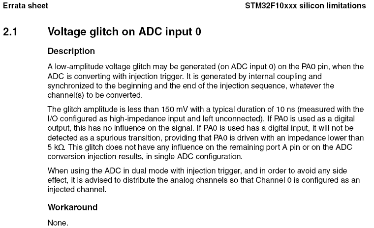

这里贴出的是STM32勘误手册中有关ADC的一个已知Bug,你可以看看是否与你的测试结果相关。

俺对主要段落代劳翻译一下:
The glitch amplitude is less than 150 mv with a typical duration of 10 ns(measured with the I/O configured as high-impedance input and left unconnected).
那尖峰脉冲小于150 mv ,典型的宽度是10纳秒。(测量时IO口设置成高阻抗,并且IO口处于浮空状态)
If PA0 is used as a digital output, this has no influence on the signal.
如果PA0设定为数字输出,尖峰脉冲对其没有影响。
if PA0 is used has a digital input,it will not be detected as a spurious transition,providing that PA0 is driven with an impedance lower than 5K 。
如果PA0连接的电阻少于5K,把PA0作为输入也不会贞测到尖峰脉冲造成的虚假转换。
This glitch does not have any influence on the remaining port A pin or on the ADC conversion injection results,in single ADC configuration.
这尖脉冲对PA口的其它脚没有任何影响,也没有影响到其它PA口ADC单独设置的转换结果。
