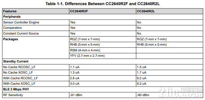

1 Differences Between CC2640R2F and CC2640R2LCC2640R2L is the latest generation of ultra-low power wireless MCUs for 2.4 GHz operation from TexasInstruments. The CC2640R2L supports Bluetooth® low energy as well as proprietary RF.Please see the table below that highlights the major differences between the two devices:
