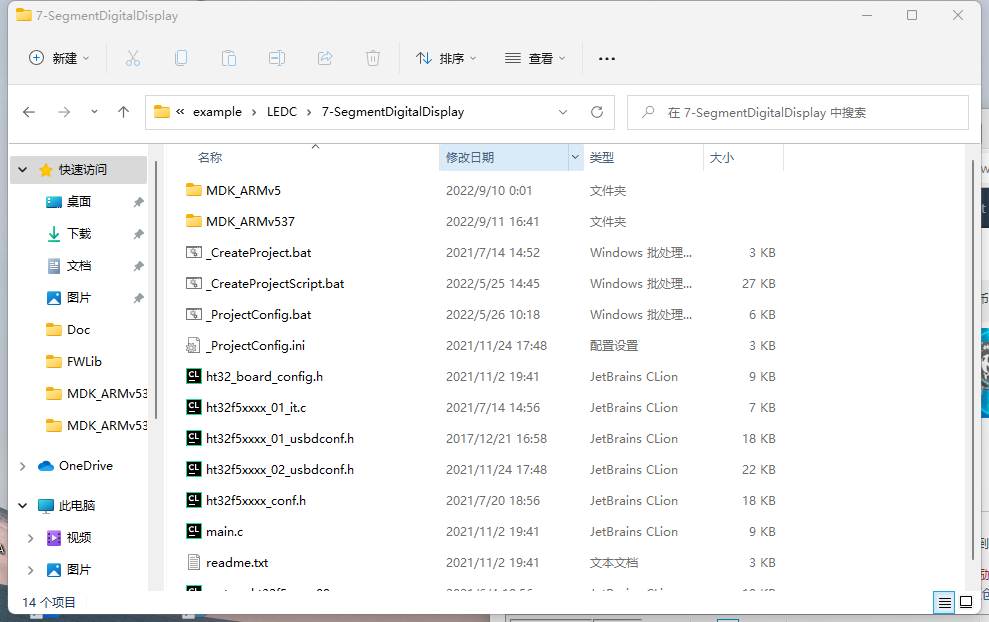

一、移植LEDC
我们的LEDC的文件存放在.\example\LEDC\7-SegmentDigitalDisplay。

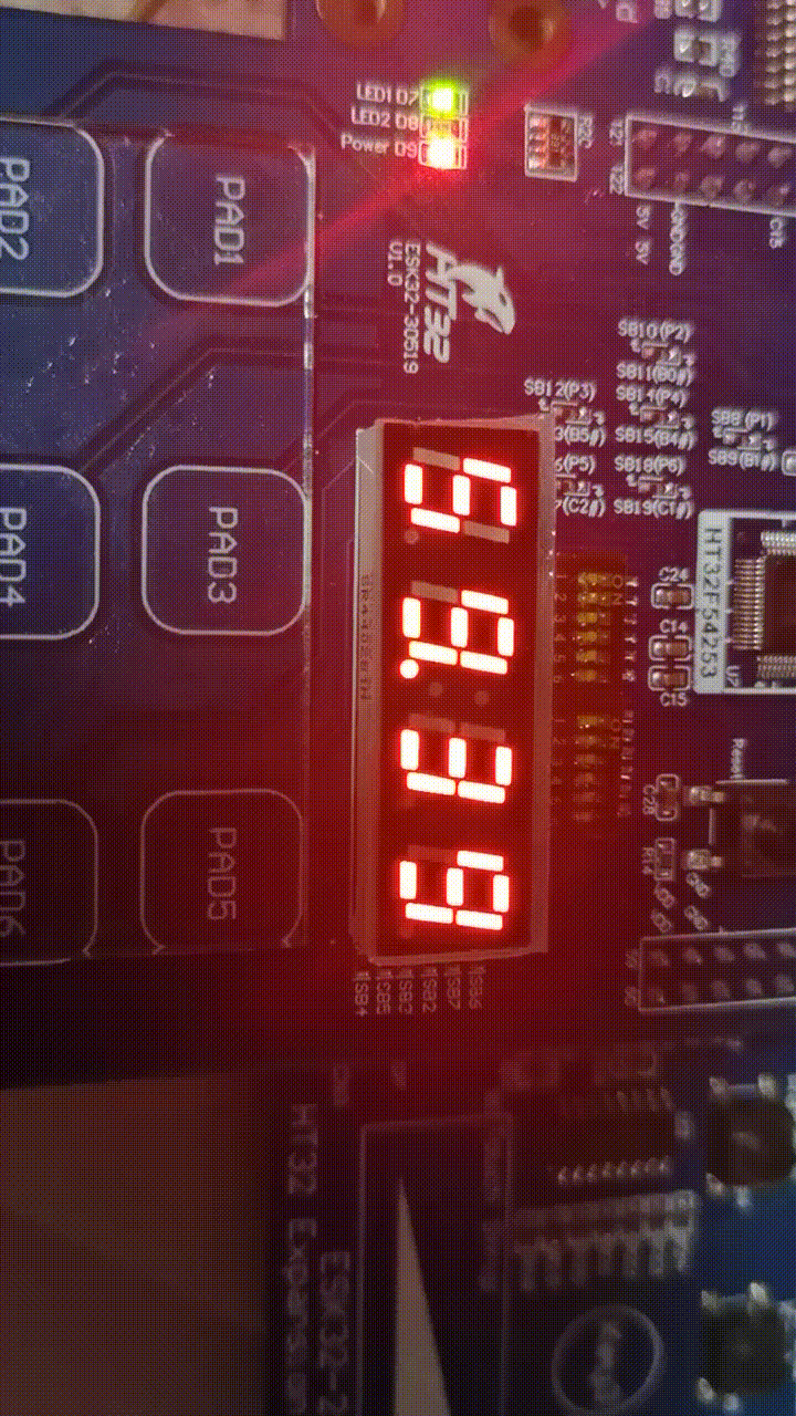

二、数据处理
  1. void Uint_List(u16 num,u8* dig1,u8* dig2,u8* dig3,u8* dig4)
  3.         if(num>=9999)
  4.                 {
  5.                         *dig1=9;
  6.                         *dig2=9;
  7.                         *dig3=9;
  8.                         *dig4=9;
  9.                 }else{
  10.                         *dig1 = num/1000;
  11.                         *dig2 = num/100%10;
  12.                         *dig3 = num/10%10;
  13.                         *dig4 = num%10;
  14.                 }
  15. }
  16. void LEDC_Uint_Display(u16 num)
  17. {
  18.         u8 dig1=0,dig2=0,dig3=0,dig4=0,dp1=0,dp2=0,dp3=0,dp4=0;
  19.         if(gIsUpdateChar)
  20.         {
  21.
  22.                 Uint_List(num,&dig1,&dig2,&dig3,&dig4);
  23.
  24.                 LEDC_SetData(HTCFG_LEDC_COM_D1,  NumberChar[dig1]);
  25.     LEDC_SetData(HTCFG_LEDC_COM_D2,  NumberChar[dig2]);
  26.     LEDC_SetData(HTCFG_LEDC_COM_D3,  NumberChar[dig3]);
  27.           LEDC_SetData(HTCFG_LEDC_COM_D4,  NumberChar[dig4]);
  28.
  29.                 gIsUpdateChar = FALSE;
  30.         }
  31. }
  32. void Float_List(float num,u8* dig1,u8* dig2,u8* dig3,u8* dig4,u8* dp1,u8* dp2,u8* dp3,u8* dp4)
  33. {
  34.         if(num>0.0f&&num<10.0f)
  35.         {
  36.                 *dp1=10;
  37.                 *dp2=11;
  38.                 *dp3=11;
  39.                 *dp4=11;
  40.                 *dig1 = (u8)num;
  41.                 *dig2 = (u8)(num*10)%10;
  42.                 *dig3 = (u8)((u16)(num*100)%10);
  43.                 *dig4 = (u8)((u16)(num*1000)%10);
  44.         }else if(num>=10.0f&&num<100.0f)
  45.         {
  46.                 *dp1=11;
  47.                 *dp2=10;
  48.                 *dp3=11;
  49.                 *dp4=11;
  50.                 *dig1 = (u8)num/10;
  51.                 *dig2 = (u8)(num)%10;
  52.                 *dig3 = (u8)((u16)(num*10)%10);
  53.                 *dig4 = (u8)((u16)(num*100)%10);
  54.         }else if(num>=100.0f&&num<1000.0f)
  55.         {
  56.                 *dp1=11;
  57.                 *dp2=11;
  58.                 *dp3=10;
  59.                 *dp4=11;
  60.                 *dig1 = (u8)num/100;
  61.                 *dig2 = (u8)(num)/10%10;
  62.                 *dig3 = (u8)((u16)(num)%10);
  63.                 *dig4 = (u8)((u16)(num*10)%10);
  64.         }else{
  65.                 *dp1=11;
  66.                 *dp2=11;
  67.                 *dp3=11;
  68.                 *dp4=10;
  69.                 Uint_List((u16)num,dig1,dig2,dig3,dig4);
  70.         }
  71.
  72. }
  73. void LEDC_Float_Display(float num)
  74. {
  75.         u8 dig1=0,dig2=0,dig3=0,dig4=0,dp1=0,dp2=0,dp3=0,dp4=0;
  76.         if(gIsUpdateChar)
  77.         {
  78.                 Float_List(num,&dig1,&dig2,&dig3,&dig4,&dp1,&dp2,&dp3,&dp4);
  79.
  80.                 LEDC_SetData(HTCFG_LEDC_COM_D1,  NumberChar[dig1]+NumberChar[dp1]);
  81.     LEDC_SetData(HTCFG_LEDC_COM_D2,  NumberChar[dig2]+NumberChar[dp2]);
  82.     LEDC_SetData(HTCFG_LEDC_COM_D3,  NumberChar[dig3]+NumberChar[dp3]);
  83.           LEDC_SetData(HTCFG_LEDC_COM_D4,  NumberChar[dig4]+NumberChar[dp4]);
  84.
  85.                 gIsUpdateChar = FALSE;
  86.         }
  87. }
暂时还没有对负号进行处理
