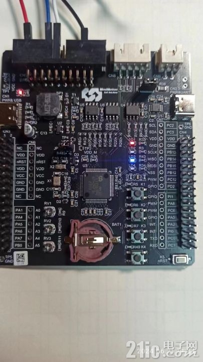

点灯程序
  1. int main(void)
  3.     PLATFORM_Init();
  4.     GPIO_LED_Toggle_Sample();
  5.     while (1)
  6.     {
  7.     }
  8. }
  1. void GPIO_LED_Toggle_Sample(void)
  3.     printf("\r\nTest %s", __FUNCTION__);
  4.     GPIO_Configure();
  5.     while (1)
  6.     {
  7.         GPIO_IO_Toggle(GPIOB, GPIO_Pin_10);
  8.         GPIO_IO_Toggle(GPIOB, GPIO_Pin_11);
  9.         GPIO_IO_Toggle(GPIOC, GPIO_Pin_6);
  10.         GPIO_IO_Toggle(GPIOC, GPIO_Pin_7);
  11.         PLATFORM_DelayMS(100);
  12.     }
  13. }

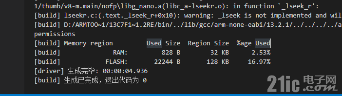

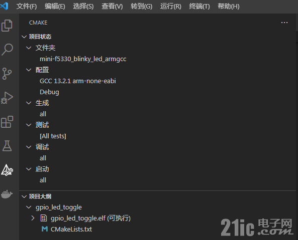

cmate tools配置
生成:

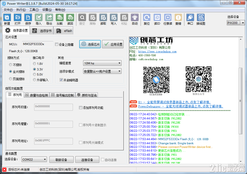

用POWERWRITE烧录
运行:
