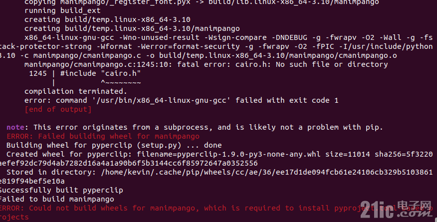

安装manim遇到问题
2989|2
 楼主| keer_zu 发表于 2024-11-24 17:04 | 显示全部楼层 |阅读模式
安装manim
  1. # Install manimgl
  2. pip install manimgl
  1. I am on a WSL Ubuntu, and I was hitting the same issue. I was able to resolve it with the recommendation from TonyCrane, in particular:
  2. apt install libpango1.0-dev pkg-config python3-dev
  3. pip install manimpango
  4. pip install manim
