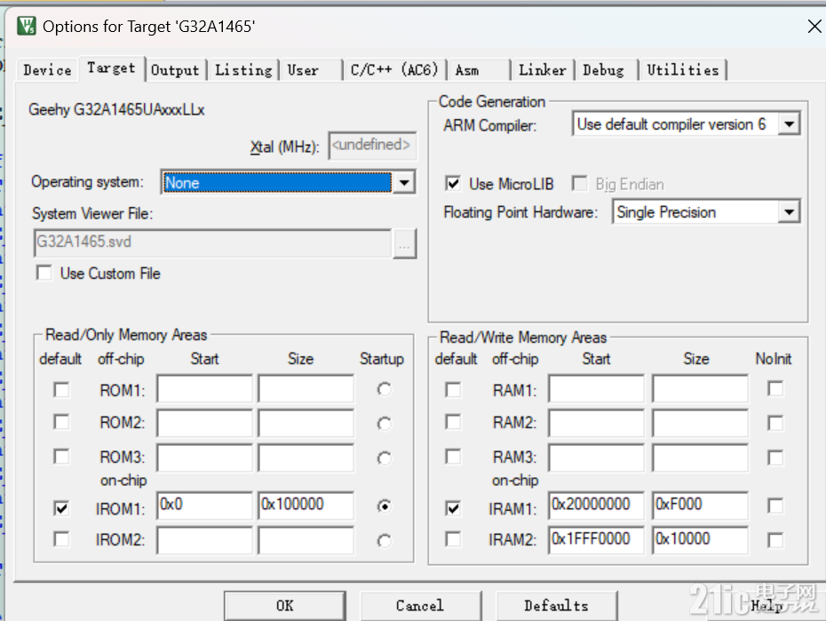

这是软件浮点库qfplib在关闭硬件FPU时测量的性能时间

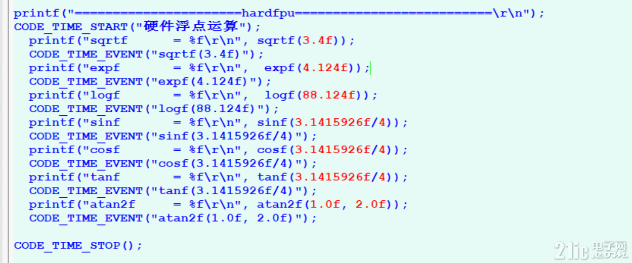

2.做硬件浮点性能测试
修改代码如下
printf("======================hardfpu==========================\r\n");
CODE_TIME_START("硬件浮点运算");
        printf("sqrtf      = %f\r\n", sqrtf(3.4f));
        CODE_TIME_EVENT("sqrtf(3.4f)");
        printf("expf       = %f\r\n",  expf(4.124f));
        CODE_TIME_EVENT("expf(4.124f)");
        printf("logf       = %f\r\n",  logf(88.124f));
        CODE_TIME_EVENT("logf(88.124f)");
        printf("sinf       = %f\r\n", sinf(3.1415926f/4));
        CODE_TIME_EVENT("sinf(3.1415926f/4)");
        printf("cosf       = %f\r\n", cosf(3.1415926f/4));
        CODE_TIME_EVENT("cosf(3.1415926f/4)");
        printf("tanf       = %f\r\n", tanf(3.1415926f/4));
  CODE_TIME_EVENT("tanf(3.1415926f/4)");
        printf("atan2f     = %f\r\n", atan2f(1.0f, 2.0f));
        CODE_TIME_EVENT("atan2f(1.0f, 2.0f)");
CODE_TIME_STOP();可以看出,软件Qfplib库的浮点运算能力已经非常接近硬件浮点运算的能力,该汇编库已经把性能发挥到了极致!!!!
