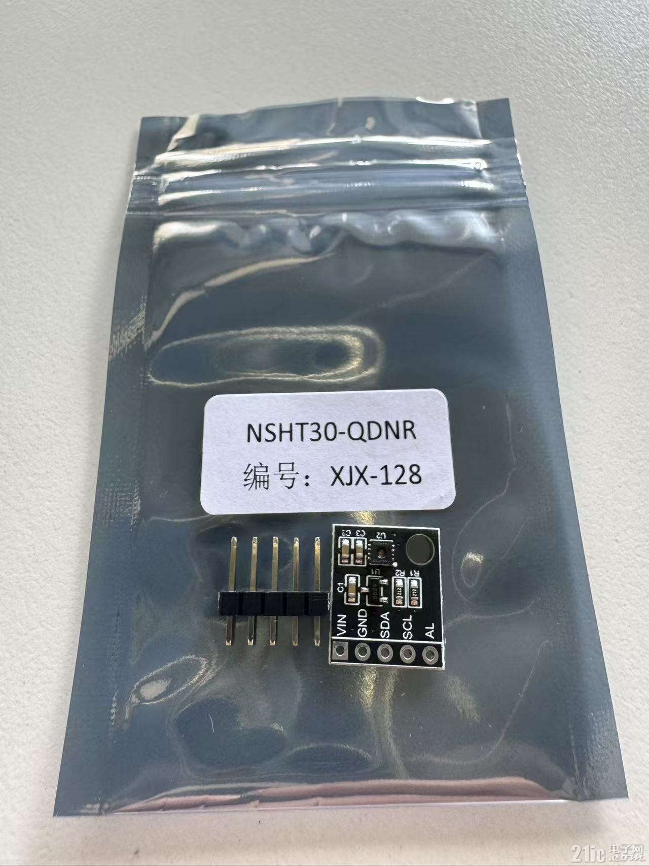

rickluo 发表于 2025-3-22 11:34 | 显示全部楼层
#define GET_I2C_SDA()             GPIO_ReadDataBit(GPIOF,GPIO_Pin_7)    // 读取SDA端口
#define SET_I2C_SCL()             GPIO_SetBits(GPIOF,GPIO_Pin_6)          // 时钟线SCL输出高电平
#define CLR_I2C_SCL()             GPIO_ResetBits(GPIOF,GPIO_Pin_6)        // 时钟线SCL输出低电平
#define SET_I2C_SDA()             GPIO_SetBits(GPIOF,GPIO_Pin_7)          // 数据线SDA输出高电平
#define CLR_I2C_SDA()             GPIO_ResetBits(GPIOF,GPIO_Pin_7)        // 数据线SDA输出低电平
#define I2C_DELAY           10

#define NSHT30_DEV_ADDR                            0x44 //NSHT30的设备地址
#define NSHT30_I2C_WR                                       0                //写控制bit
#define NSHT30_I2C_RD                1                // 读控制bit
#define TRIG_TEMP_MEASUREMENT_HM          0xE3   // command trig. temp meas. hold master
#define TRIG_HUMI_MEASUREMENT_HM                0xE5    // command trig. humiditymeas. hold master
#define TRIG_TEMP_MEASUREMENT_POLL            0xF3    // command trig. tempmeas. no hold master
#define TRIG_HUMI_MEASUREMENT_POLL    0xF5    // command trig. humiditymeas. no hold master
#define TRIG_TEMP_HUMI_MEASUREMENT    0x2C06   // command trig.humidity  temp meas
#define NSHT30_SOFT_RESET                0x30A2    // command soft reset
#define NSHT30_RESOLUTION_REG                         0xE6   // 设置分辨率寄存器地址
#define NSHT30_RESOLUTION_VAL                         0x83   // 设置分辨率bit7 = 1,bit0 = 0,对应湿度10bit,温度13bit
#define NSHT30_READ_REG                                              0XE7
//NSHT30驱动代码
#define CMD_MEAS_SINGLE_H 0x2400 //measurement: SINGLE Mode high repeatability
#define CMD_MEAS_SINGLE_M 0x240B //measurement: SINGLE Mode medium repeatability
#define CMD_MEAS_SINGLE_L 0x2416 //measurement: SINGLE Mode low repeatability
#define CMD_MEAS_PERI_05_H 0x2032 //measurement: periodic Mode 0.5 mps high repeatability
#define CMD_MEAS_PERI_05_M 0x2024 //measurement: periodic Mode 0.5 mps medium repeat[1]ability
#define CMD_MEAS_PERI_05_L 0x202F //measurement: periodic Mode 0.5 mps low repeatability
#define CMD_MEAS_PERI_1_H 0x2130 //measurement: periodic Mode 1 mps high repeatability
#define CMD_MEAS_PERI_1_M 0x2126 //measurement: periodic Mode 1 mps medium repeatability
#define CMD_MEAS_PERI_1_L 0x212D //measurement: periodic Mode 1 mps low repeatability
#define CMD_MEAS_PERI_2_H 0x2236 //measurement: periodic Mode 2 mps high repeatability
#define CMD_MEAS_PERI_2_M 0x2220 //measurement: periodic Mode 2 mps medium repeatability
#define CMD_MEAS_PERI_2_L 0x222B //measurement: periodic Mode 2 mps low repeatability
#define CMD_MEAS_PERI_4_H 0x2334 //measurement: periodic Mode 4 mps high repeatability
#define CMD_MEAS_PERI_4_M 0x2322 //measurement: periodic Mode 4 mps medium repeatability
#define CMD_MEAS_PERI_4_L 0x2329 //measurement: periodic Mode 4 mps low repeatability
#define CMD_MEAS_PERI_10_H 0x2737 //measurement: periodic Mode 10 mps high repeatability
#define CMD_MEAS_PERI_10_M 0x2721 //measurement: periodic Mode 10 mps medium repeat[1]ability
#define CMD_MEAS_PERI_10_L 0x272A //measurement: periodic Mode 10 mps low repeatability
static bool Nsht30SoftReset(void)
         I2CStart();
         I2CSendByte((NSHT30_DEV_ADDR<<1)| NSHT30_I2C_WR);
         if(!I2CWaitAck())
                   gotoi2c_err;
         I2CSendByte((NSHT30_SOFT_RESET&0xFF00)>>8);
         if(!I2CWaitAck())
                   gotoi2c_err;
         I2CSendByte(NSHT30_SOFT_RESET&0xFF);
         if(!I2CWaitAck())
                   gotoi2c_err;
         I2CStop();
         returntrue;
i2c_err:          // 命令执行失败后,要发送停止信号,避免影响I2C总线上其他设备
         I2CStop();
         returnfalse;
static bool Nsht30SetResolution(uint8_t*pBuffer)
         uint16_tnumToRead=5;
         I2CStart();
         if(!I2CWaitAck())
                   gotoi2c_err;
         I2CSendByte((CMD_MEAS_SINGLE_L&0xFF00)>>8);
         if(!I2CWaitAck())
                   gotoi2c_err;
         I2CSendByte(CMD_MEAS_SINGLE_L&0xFF);
         if(!I2CWaitAck())
                   gotoi2c_err;
         I2CStop();
         DelayNms(I2C_DELAY);
         I2CStart();                                        // 发送起始信号
         I2CSendByte((NSHT30_DEV_ADDR<<1)| NSHT30_I2C_RD);      // 发送器件地址和读写模式,1 0 1 0 x  x  x R/~W  0xA1
         if(!I2CWaitAck())                                // 等待应答
                   gotoi2c_err;
         while(numToRead--)                                // 数据未读完
                   *pBuffer++= I2CReadByte();                   // 逐字节读出存放到数据数组
                   I2CSendAck();
         *pBuffer= I2CReadByte();                        // 最后一个字节发送非应答
         I2CSendNack();
         I2CStop();
         I2CStop();
         returnfalse;
bool TempHumizhuanhuan(uint8_t *dat,double*pot)
         uint16_ttem,hum;
         tem= ((uint16_t)dat[0]<<8) | dat[1];
         hum= ((uint16_t)dat[3]<<8) | dat[4];
         if((crc8(dat,2)== dat[2]) && (crc8(dat+3,2) == dat[5]))
                   pot[0]=(175.0*(double)tem/65535.0-45.0) ;// T = -45 + 175 * tem / (2^16-1)
                   pot[1]=(100.0*(double)hum/65535.0);// RH = hum*100 / (2^16-1)
                   return1;
         else
                   return0;
float tempData, humiData;
uint8_t buffer[10];
double rth[2];
void TempHumiDrvTest(void)
         Nsht30SetResolution(buffer);
         printf("Get%x %x %x %x %x%x\n",buffer[0],buffer[1],buffer[2],buffer[3],buffer[4],buffer[5]);
         TempHumizhuanhuan(buffer,rth);
         printf("%3.4f,%3.6f%%\r\n",rth[0],rth[1]);
