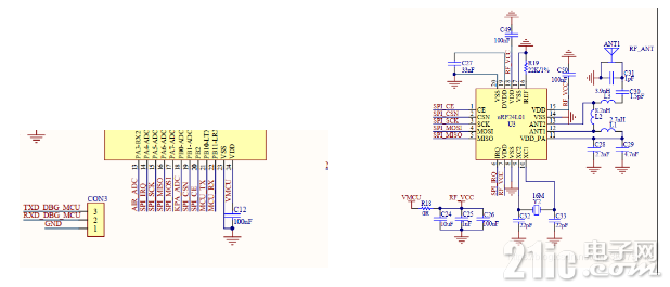

1)原理图:

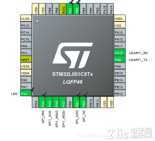

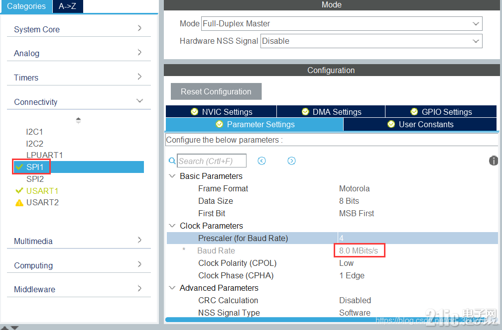

STM32CubeMx工具配置如下:

  10. #define NRF24L01_SPI_GPIO_PORT                        GPIOA
  11. #define NRF24L01_SPI_SCK_PIN                          GPIO_PIN_5
  12. #define NRF24L01_SPI_MISO_PIN                         GPIO_PIN_6
  13. #define NRF24L01_SPI_MOSI_PIN                         GPIO_PIN_7
  14. #define NRF24L01_SPI_CS_CLK_ENABLE()                  __HAL_RCC_GPIOB_CLK_ENABLE()
  15. #define NRF24L01_SPI_CS_PORT                          GPIOB
  16. #define NRF24L01_SPI_CS_PIN                           GPIO_PIN_1
  17. #define NRF24L01_SPI_CS_ENABLE()                      HAL_GPIO_WritePin(NRF24L01_SPI_CS_PORT, NRF24L01_SPI_CS_PIN, GPIO_PIN_RESET)
  18. #define NRF24L01_SPI_CS_DISABLE()                     HAL_GPIO_WritePin(NRF24L01_SPI_CS_PORT, NRF24L01_SPI_CS_PIN, GPIO_PIN_SET)
  19. #define NRF24L01_CE_CLK_ENABLE()                      __HAL_RCC_GPIOB_CLK_ENABLE()
  20. #define NRF24L01_CE_PORT                              GPIOB
  21. #define NRF24L01_CE_PIN                               GPIO_PIN_2
  22. #define NRF24L01_CE_LOW()                             HAL_GPIO_WritePin(NRF24L01_CE_PORT, NRF24L01_CE_PIN, GPIO_PIN_RESET)
  23. #define NRF24L01_CE_HIGH()                            HAL_GPIO_WritePin(NRF24L01_CE_PORT, NRF24L01_CE_PIN, GPIO_PIN_SET)
  24. #define NRF24L01_IRQ_CLK_ENABLE()                     __HAL_RCC_GPIOA_CLK_ENABLE()
  25. #define NRF24L01_IRQ_PORT                             GPIOA
  26. #define NRF24L01_IRQ_PIN                              GPIO_PIN_4
  27. #define NRF24L01_IRQ_PIN_READ()                       HAL_GPIO_ReadPin(NRF24L01_IRQ_PORT,NRF24L01_IRQ_PIN)

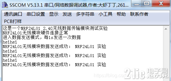

  42.         NRF24L01_TX_Mode();
  43.   printf("进入数据发送模式,每1s发送一次数据\n");
  44.
  45.   /* USER CODE END 2 */
  46.   /* Infinite loop */
  47.   /* USER CODE BEGIN WHILE */
  48.   while (1)
  49.   {
  50.                 HAL_GPIO_TogglePin(GPIOA,LED_Pin);
  51.                 HAL_Delay(1000);
  52.                 printf("heihei\r\n");
  53.     /* USER CODE END WHILE */
  54.     /* USER CODE BEGIN 3 */
  55.                 if(NRF24L01_TxPacket(tmp_buf)==TX_OK)
  56.     {
  57.       printf("NRF24L01无线模块数据发送成功:%s\n",tmp_buf);
  58.     }
  59.     else
  60.     {
  61.       printf("NRF24L01无线模块数据发送失败\n");
  62.     }
  63.   }
  64.   /* USER CODE END 3 */
  65. }
 楼主| l63t89 发表于 2024-3-27 17:09 | 显示全部楼层
STM32与NRF24L01能正常通讯,并能成功发送数据
