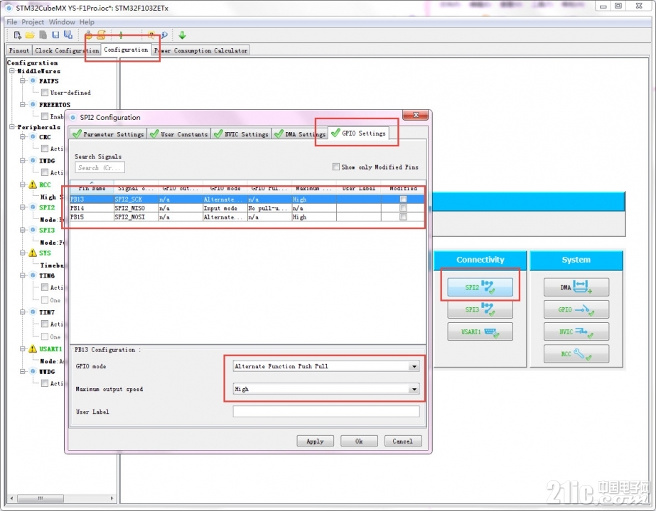

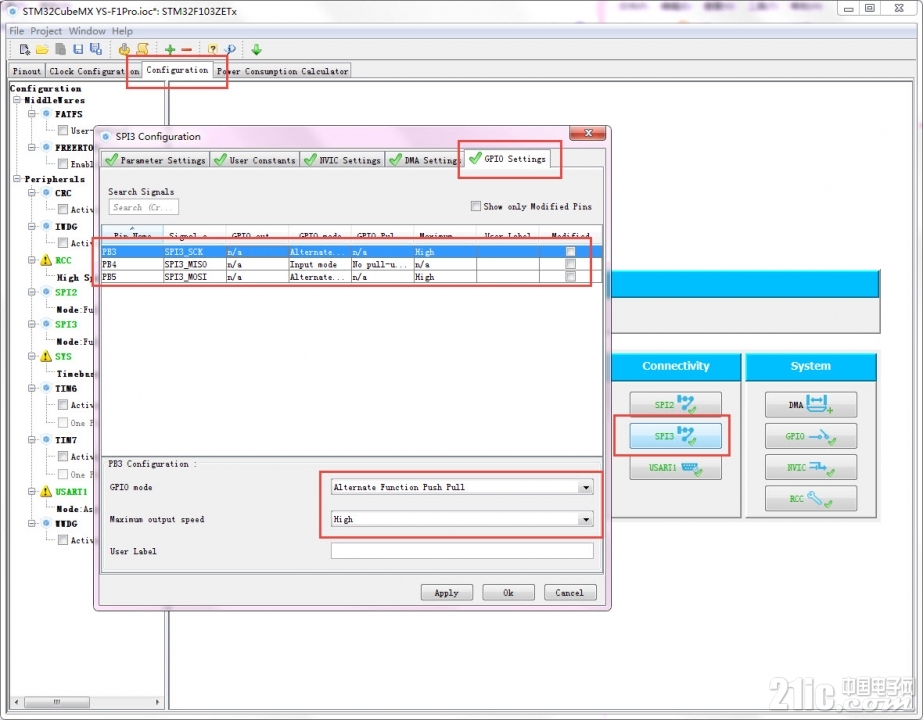

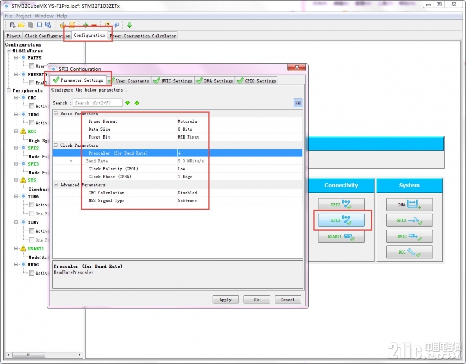

将NRF24L01模块插入到使用开发板的CN14接口上,拔掉JP8和JP9两个跳线帽。使用杜邦线连接另外
一个NRF24L01模块(参考bsp_NRF24L01.h文件内容)。将配套的MINI USB线连接到开发板标示“调
试串口”字样的MIMI USB接口(需要安装驱动),在电脑端打开串口调试助手工具,设置参数为
115200 8-N-1。下载完程序之后,在串口调试助手窗口可接收到信息。

  35. void NRF24L01_SPI_Init(void)
  36. {
  37.   hspi_NRF24L01_1.Instance = NRF24L01_1_SPIx;
  38.   hspi_NRF24L01_1.Init.Mode = SPI_MODE_MASTER;
  39.   hspi_NRF24L01_1.Init.Direction = SPI_DIRECTION_2LINES;
  40.   hspi_NRF24L01_1.Init.DataSize = SPI_DATASIZE_8BIT;
  41.   hspi_NRF24L01_1.Init.CLKPolarity = SPI_POLARITY_LOW;
  42.   hspi_NRF24L01_1.Init.CLKPhase = SPI_PHASE_1EDGE;
  43.   hspi_NRF24L01_1.Init.NSS = SPI_NSS_SOFT;
  44.   hspi_NRF24L01_1.Init.BaudRatePrescaler = SPI_BAUDRATEPRESCALER_4;
  45.   hspi_NRF24L01_1.Init.FirstBit = SPI_FIRSTBIT_MSB;
  46.   hspi_NRF24L01_1.Init.TIMode = SPI_TIMODE_DISABLE;
  47.   hspi_NRF24L01_1.Init.CRCCalculation = SPI_CRCCALCULATION_DISABLE;
  48.   hspi_NRF24L01_1.Init.CRCPolynomial = 10;
  49.   HAL_SPI_Init(&hspi_NRF24L01_1);
  50.   __HAL_SPI_ENABLE(&hspi_NRF24L01_1);
  51.
  52.   hspi_NRF24L01_2.Instance = NRF24L01_2_SPIx;
  53.   hspi_NRF24L01_2.Init.Mode = SPI_MODE_MASTER;
  54.   hspi_NRF24L01_2.Init.Direction = SPI_DIRECTION_2LINES;
  55.   hspi_NRF24L01_2.Init.DataSize = SPI_DATASIZE_8BIT;
  56.   hspi_NRF24L01_2.Init.CLKPolarity = SPI_POLARITY_LOW;
  57.   hspi_NRF24L01_2.Init.CLKPhase = SPI_PHASE_1EDGE;
  58.   hspi_NRF24L01_2.Init.NSS = SPI_NSS_SOFT;
  59.   hspi_NRF24L01_2.Init.BaudRatePrescaler = SPI_BAUDRATEPRESCALER_4;
  60.   hspi_NRF24L01_2.Init.FirstBit = SPI_FIRSTBIT_MSB;
  61.   hspi_NRF24L01_2.Init.TIMode = SPI_TIMODE_DISABLE;
  62.   hspi_NRF24L01_2.Init.CRCCalculation = SPI_CRCCALCULATION_DISABLE;
  63.   hspi_NRF24L01_2.Init.CRCPolynomial = 10;
  64.   HAL_SPI_Init(&hspi_NRF24L01_2);
  65.   __HAL_SPI_ENABLE(&hspi_NRF24L01_2);
  66. }
  67. /**
  68.   * 函数功能: SPI外设系统级初始化
  69.   * 输入参数: hspi:SPI句柄类型指针
  70.   * 返 回 值: 无
  71.   * 说    明: 该函数被HAL库内部调用
  72.   */
  73. void HAL_SPI_MspInit(SPI_HandleTypeDef* hspi)
  74. {
  75.   GPIO_InitTypeDef GPIO_InitStruct;
  76.   if(hspi->Instance==NRF24L01_1_SPIx)
  77.   {
  78.     /* SPI外设时钟使能 */
  79.     NRF24L01_1_SPIx_RCC_CLK_ENABLE();
  80.     /* GPIO外设时钟使能 */
  81.     NRF24L01_1_SPI_GPIO_ClK_ENABLE();
  82.     NRF24L01_1_SPI_CS_CLK_ENABLE();
  83.     NRF24L01_1_CE_CLK_ENABLE();
  84.     NRF24L01_1_IRQ_CLK_ENABLE();
  85.
  86.     /* Disable the Serial Wire Jtag Debug Port SWJ-DP */
  87.     __HAL_AFIO_REMAP_SWJ_DISABLE();
  88.
  89.     /**SPI3 GPIO Configuration
  90.     PF11     ------> SPI3_NSS
  91.     PB3      ------> SPI3_SCK
  92.     PB4      ------> SPI3_MISO
  93.     PB5      ------> SPI3_MOSI
  94.     */
  95.     GPIO_InitStruct.Pin = NRF24L01_1_SPI_SCK_PIN|NRF24L01_1_SPI_MOSI_PIN;
  96.     GPIO_InitStruct.Mode = GPIO_MODE_AF_PP;
  97.     GPIO_InitStruct.Speed = GPIO_SPEED_FREQ_HIGH;
  98.     HAL_GPIO_Init(NRF24L01_1_SPI_GPIO_PORT, &GPIO_InitStruct);
  99.     GPIO_InitStruct.Pin = NRF24L01_1_SPI_MISO_PIN;
  100.     GPIO_InitStruct.Mode = GPIO_MODE_INPUT;
  101.     GPIO_InitStruct.Pull = GPIO_NOPULL;
  102.     HAL_GPIO_Init(NRF24L01_1_SPI_GPIO_PORT, &GPIO_InitStruct);
  103.
  104.     HAL_GPIO_WritePin(NRF24L01_1_SPI_CS_PORT, NRF24L01_1_SPI_CS_PIN, GPIO_PIN_SET);
  105.     GPIO_InitStruct.Pin = NRF24L01_1_SPI_CS_PIN;
  106.     GPIO_InitStruct.Mode = GPIO_MODE_OUTPUT_PP;
  107.     HAL_GPIO_Init(NRF24L01_1_SPI_CS_PORT, &GPIO_InitStruct);
  108.
  109.     HAL_GPIO_WritePin(NRF24L01_1_CE_PORT, NRF24L01_1_CE_PIN, GPIO_PIN_RESET);
  110.     GPIO_InitStruct.Pin = NRF24L01_1_CE_PIN;
  111.     GPIO_InitStruct.Mode = GPIO_MODE_OUTPUT_PP;
  112.     HAL_GPIO_Init(NRF24L01_1_CE_PORT, &GPIO_InitStruct);
  113.
  114.     GPIO_InitStruct.Pin = NRF24L01_1_IRQ_PIN;
  115.     GPIO_InitStruct.Mode = GPIO_MODE_INPUT;
  116.     GPIO_InitStruct.Pull = GPIO_PULLUP;
  117.     HAL_GPIO_Init(NRF24L01_1_IRQ_PORT, &GPIO_InitStruct);
  118.   }
