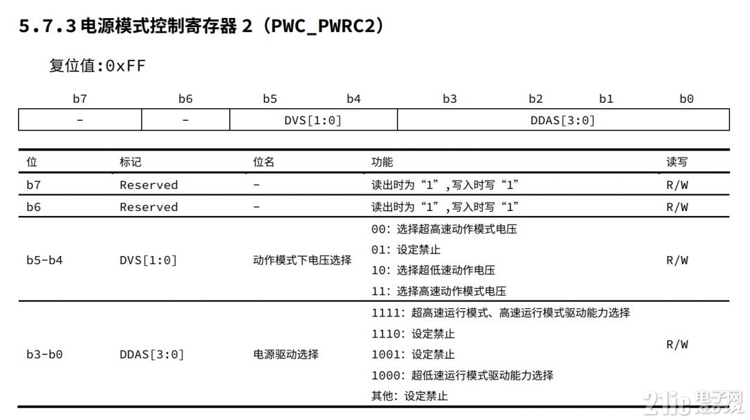

继搞定GPIO后,搞定了时钟系统。
3950|14
没有用库,因为感觉用库不爽。(不想比较,因为新事物毛病多是正常的)
贴出来,支持国产!

void ClkInit(void)
        uint16_t tmp;
        // PC14, PC15, PH0, PH1 as the xtal pin
        GPIO_UNLOCK();
        CM_GPIO->PCRC14                        |= 0x8000;
        CM_GPIO->PCRC15                        |= 0x8000;
        CM_GPIO->PCRH0                        |= 0x8000;
        CM_GPIO->PCRH1                        |= 0x8000;
        GPIO_LOCK();
        /**** switch to XTAL ( 10MHz )                *************************/
        PWR_UNLOCK();
        CM_CMU->XTALCFGR                = 0xA0;                // XTAL, drive small
        CM_CMU->XTALSTBCR                = 8;                // stable time is 8163 circle
        CM_CMU->XTALCR                        = 0;                // start XTAL
        while (!( CM_CMU->OSCSTBSR & XTAL_STABLE ))
        CM_CMU->XTAL32CFGR                = 0;                // MID        drive
        CM_CMU->XTAL32CR                = 0;                // start
        PWR_LOCK();
        /**** M-VCO = 400MHz, U-VCO = 240MHz                ********************/
        PWR_UNLOCK();
        CM_CMU->PLLCFGR                        = PLL_P(1)                /*200MHz*/
                                                        | PLL_Q(3)                /* 100MHz*/
                                                        | PLL_R(7)                /* 50MHz*/
                                                        | PLL_N(19)                /* 10MHz x 20 */
                                                        | PLL_XTAL_IN()
                                                        | PLL_M(0);
        CM_CMU->UPLLCFGR                = PLL_P(4)                /* 48MHz*/
                                                        | PLL_Q(3)                /* 60MHz*/
                                                        | PLL_R(1)                /* 120MHz*/
                                                        | PLL_N(47)                /* 5MHz x 48 */
                                                        | PLL_XTAL_IN()
                                                        | PLL_M(1);                /* frequency division = 2 , input frequency = 5MHz */
        CM_CMU->PLLCR                        = 0;
        CM_CMU->UPLLCR                        = 0;
        while (!( CM_CMU->OSCSTBSR & MPLL_STABLE )){}
        while (!( CM_CMU->OSCSTBSR & UPLL_STABLE )){}
        PWR_LOCK();
        /*******************         FLASH and SRAM insert wait circle                ************/
        CM_EFM->FAPRT        = 0x0123;
        CM_EFM->FAPRT        = 0x3210;        // Unlock flash
        CM_EFM->FRMC                |= FLASH_READ_WAIT(5);                        // data sheet V1.6 page 179
        CM_EFM->FAPRT        = 0x4567;        // lock
        SRAM_UNLOCK();
        CM_SRAMC->WTCR                = RET_RAM_WRITE_WAIT(1)
                                                | RET_RAM_READ_WAIT(1)
                                                | RAM3_WRITE_WAIT(1)
                                                | RAM3_READ_WAIT(1)
                                                | RAM12_WRITE_WAIT(1)
                                                | RAM12_READ_WAIT(1);
        SRAM_LOCK();
        /************                system clock select         **********
                sys clock = 200MHz
                SDUI clock = 100MHz
                ADC control = 100MHz
                PCK3 = 50MHz
                PCK2 =50MHz ,ADC converter
                PCK1 = 100MHz, uart, TA,T4,T6
        tmp = CM_CMU->OSCSTBSR;
        if (( tmp & XTAL_STABLE ) && ( tmp & MPLL_STABLE ))
                PWR_UNLOCK();
                CM_CMU->CKSWR                = 5;                // system clock is MPLL-P, 200MHz
                CM_CMU->SCFGR                = HCLK_DIV(0) | EXCLK_DIV(1) | PCLK4_DIV(1) | PCLK3_DIV(2) |PCLK2_DIV(2) | PCLK1_DIV(1) | PCLK0_DIV(1);
                CM_CMU->USBCKCFGR        = USBCLK_UPLL_P;
                CM_CMU->PERICKSEL        = PERCLK_SCFGR;
                CM_CMU->I2SCKSEL        = PERCLK_SCFGR;
                PWR_LOCK();
初步运行验证,正常,

wubangmi| | 2024-6-3 13:06 | 只看该作者
你说的初步两个字用的非常正确,这个升频代码还没写全,我告诉你有bug。
具体什么bug就看你批量生产了,遇到了奇怪的问题想不通的,记得在群里找人答疑。
不是写寄存器方式不好,而是你在没有完全了解MCU特性和仔细研读用户手册的前提下,不建议直接写寄存器。
换个思路考虑下问题,原厂毕竟是原厂,芯片有什么Bug,他可以在库函数里用软件方式做弥补。
原厂那么多人花那么多时间写的库,个人不觉得你写的寄存器肯定没有原厂写的周全。

dontium|  楼主 | 2024-6-3 17:28 | 只看该作者
具体什么bug就看你批量生产了,遇 ...
请问一下,具体哪个地方有BUG、愿听指导。
wubangmi| | 2024-6-4 09:41 | 只看该作者
请看截图
