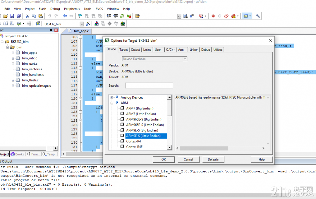

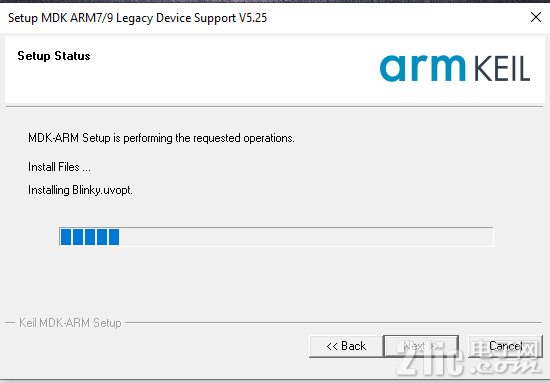

2、使用MDK开发是一个比较方便的方式,但是这里的蓝牙从模块是使用了ARM9的指令集,需要在keil扩展开发包,安装方式如下
具体的版本说明如下,这个扩展包使用与MDK5.25以后的版本
3、按照说明,需要先把蓝牙模块的栈写入
3.1 下载蓝牙栈模块代码BK3432_bim,直接编译
显然,其中的bim_app.c使用了串口通信,代码如下
  1. void bim_main(void)
  3.      extern uint16_t uart_buff_write;
  4.      extern uint8_t bim_uart_rx_buf[BIM_UART0_RX_FIFO_MAX_COUNT];
  5.      extern uint8_t uart_download_status;
  6.     static uint16_t bim_uart_temp,uart_buff_read;
  7.      static int32_t  check_cnt=0;
  8.      static uint8_t read_buf[16];
  9.      static uint16_t rom_ver;
  10.      int32_t main_point = MAIN_IMAGE_RUN_ADDR;
  11.     updata_memset32((uint8_t *)0x00400000, 1, 1);
  12.      bim_icu_init(ICU_CLK_16M);
  13.      bim_flash_init();
  14.      bim_uart_init(115200);
  15.      bim_flash_read(FLASH_SPACE_TYPE_MAIN, 0x2010/4, 16, read_buf);
  16.     rom_ver = ( read_buf[14]|(read_buf[15]<<8) );
  17.      REG_AHB0_ICU_INT_ENABLE = (0x01 << 5);
  18.      REG_AHB0_ICU_IRQ_ENABLE = 0x03;
  19.      __enable_irq();
  20.      //bim_uart_write("boot start\r\n");
  21.      //REG_APB5_GPIOD_CFG = 0Xff;
  22.      //REG_APB5_GPIOD_DATA = 0X00;
  23.      while(1)
  24.      {
  25.           bim_uart_temp=uart_buff_write;
  26.           if (uart_buff_read < bim_uart_temp)
  27.           {
  28.                //REG_APB5_GPIOD_DATA = 0X00;
  29.                bim_uart_data_callback(bim_uart_rx_buf + uart_buff_read, bim_uart_temp - uart_buff_read);
  30.                uart_buff_read = bim_uart_temp;
  31.           }
  32.          else if (uart_buff_read > bim_uart_temp)
  33.           {
  34.                bim_uart_data_callback(bim_uart_rx_buf + uart_buff_read, sizeof(bim_uart_rx_buf) - uart_buff_read);
  35.                bim_uart_data_callback(bim_uart_rx_buf, bim_uart_temp);
  36.                uart_buff_read = bim_uart_temp;
  37.                //REG_APB5_GPIOD_DATA = 0X00;
  38.           }
  39.           else
  40.          {
  41.                if(uart_download_status==0 && rom_ver!=0xffff)
  42.                {
  43.                     if(check_cnt++>50000) //30ms
  44.                     {
  45.                          check_cnt=0;
  46.                          //REG_APB5_GPIOD_DATA = 0XFF;
  47.                          break;
  48.                     }
  49.                }
  50.           }
  51.      }
  52.      __disable_irq( );
  53.      REG_AHB0_ICU_INT_ENABLE = 0x00;
  54.      REG_AHB0_ICU_IRQ_ENABLE = 0x00;
  55.     updata_memset32((uint8_t *)0x00400000, 0, 1);
  56.      bim_uart_deinit();
  57.      if(1 == bim_select_sec())
  58.      {
  59.           //bim_uart_write("image-main_RUN ADDR = 0x2010\r\n");
  60.           (*(FUNCPTR)main_point)();
  61.      }
  62. }

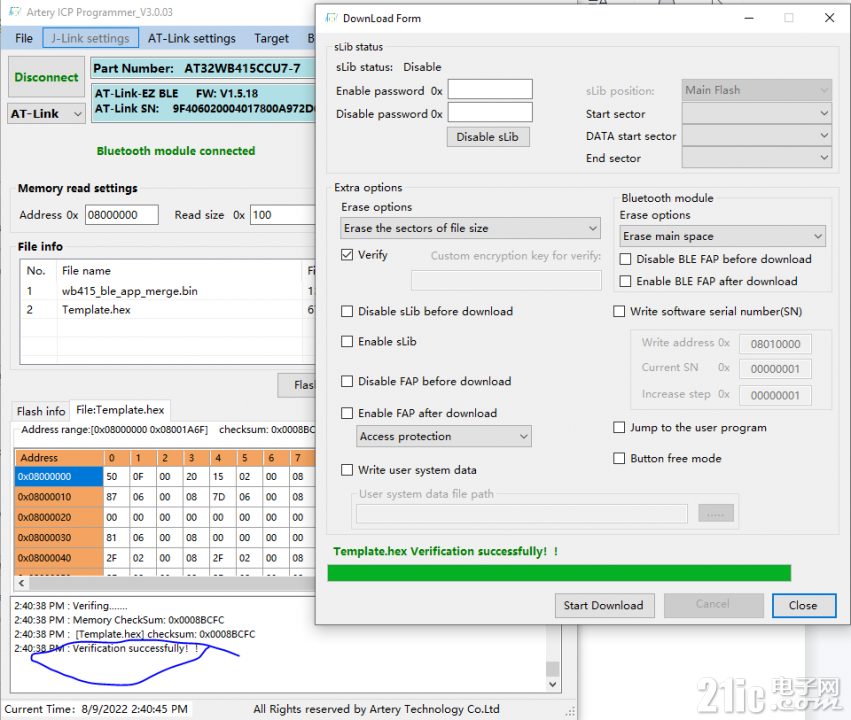

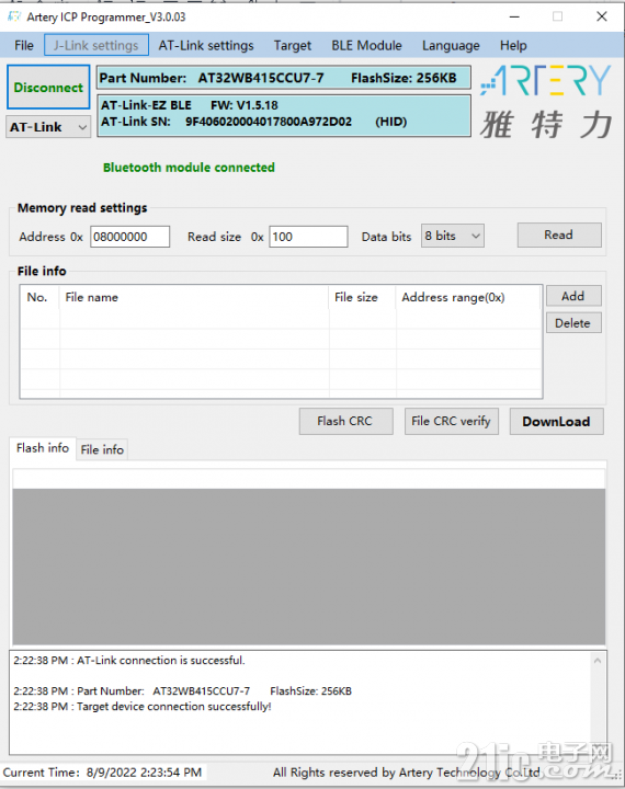

这个工程只是生产了通用代码,需要用ICP模式写入共享内存的指定位置,并不能通过这个工程直接下载并调试,可以看到这个BK3432的内核是ARM9.

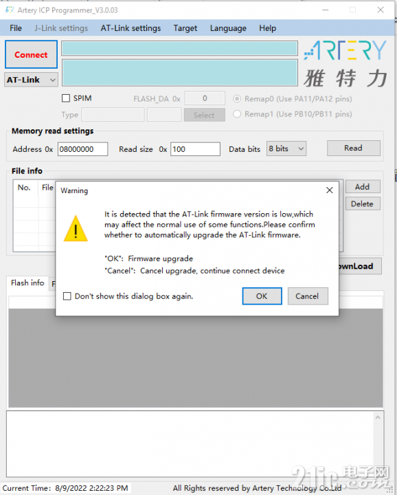

启动ICP programmer,提示升级firmware,当然可以忽略,
同样可以连接上开发板

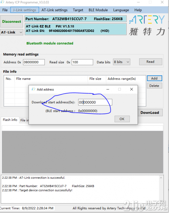

选择并添加适合的蓝牙固件,确定BLE的栈从0x00000000开始写入。选择下载就可以写入蓝牙栈代码。

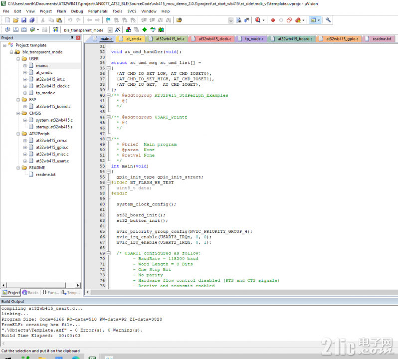

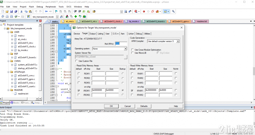

4、主工程代码的编译和运行,
下载并编译范例主MCU代码,这个是实现UART访问的功能,主要的功能就是标准的串口AT指令控制
主代码如下
  1. int main(void)
  3.   gpio_init_typegpio_init_struct;
  4. #ifdef BT_FLASH_WR_TEST
  5.   uint8_t data;
  6. #endif
  7.    system_clock_config();
  8.    at32_board_init();
  9.   at32_button_init();
  10. nvic_priority_group_config(NVIC_PRIORITY_GROUP_4);
  11. nvic_irq_enable(USART3_IRQn, 0, 0);
  12. nvic_irq_enable(USART2_IRQn, 0, 1);
  13.     /* USART1configured as follow:
  14.         -BaudRate = 115200 baud
  15.         - WordLength = 8 Bits
  16.         - One Stop Bit
  17.         - Noparity
  18.         -Hardware flow control disabled (RTS and CTS signals)
  19.         -Receive and transmit enabled
  20.   */
  21. crm_periph_clock_enable(CRM_USART3_PERIPH_CLOCK, TRUE);
  22. crm_periph_clock_enable(CRM_GPIOA_PERIPH_CLOCK, TRUE);
  23. crm_periph_clock_enable(CRM_IOMUX_PERIPH_CLOCK, TRUE);
  24. gpio_pin_remap_config(USART3_GMUX_0010, TRUE);
  25. gpio_init_struct.gpio_drive_strength = GPIO_DRIVE_STRENGTH_STRONGER;
  26. gpio_init_struct.gpio_out_type  =GPIO_OUTPUT_PUSH_PULL;
  27.   gpio_init_struct.gpio_mode= GPIO_MODE_MUX;
  28. gpio_init_struct.gpio_pins = GPIO_PINS_7;
  29. gpio_init_struct.gpio_pull = GPIO_PULL_NONE;
  30. gpio_init(GPIOA, &gpio_init_struct);
  31. gpio_init_struct.gpio_drive_strength = GPIO_DRIVE_STRENGTH_STRONGER;
  32. gpio_init_struct.gpio_out_type  =GPIO_OUTPUT_PUSH_PULL;
  33. gpio_init_struct.gpio_mode = GPIO_MODE_INPUT;
  34. gpio_init_struct.gpio_pins = GPIO_PINS_6;
  35. gpio_init_struct.gpio_pull = GPIO_PULL_UP;
  36. gpio_init(GPIOA, &gpio_init_struct);
  37. uart_print_init(115200);
  38. printf("Print Test\r\n");
  39. usart_init(USART3, 115200, USART_DATA_8BITS, USART_STOP_1_BIT);
  40. usart_transmitter_enable(USART3, TRUE);
  41. usart_receiver_enable(USART3, TRUE);
  42.   /* Enable theUSARTx Interrupt */
  43. usart_interrupt_enable(USART3, USART_RDBF_INT, TRUE);
  44.   usart_enable(USART3,TRUE);
  45.   /* Output amessage on Hyperterminal using printf function */
  46. delay_ms(1000);
  47.   while (1)
  48.   {
  49.    if(at32_button_press() == USER_BUTTON)
  50.     {
  51.      UART_TP_MODE = (flag_status)!UART_TP_MODE;
  52.      if(UART_TP_MODE)
  53.       {
  54.        switch_mode_flag = SET;
  55.        at_cmd_send(AT_CMD_TP_MODE_ON);
  56.        while(cmd_rsp_get(AT_TP_MODE_OK1) != RSP_OK);
  57.        switch_mode_flag = RESET;
  58.        at32_led_on(LED3);
  59.        printf("enter uart tp mode\r\n");
  60.       }
  61.       else
  62.       {
  63.        switch_mode_flag = SET;
  64.        at_cmd_send(AT_CMD_TP_MODE_OFF);
  65.        while(cmd_rsp_get(AT_TP_MODE_OK0) != RSP_OK);
  66.        switch_mode_flag = RESET;
  67.        at32_led_off(LED3);
  68.        printf("leave uart tp mode\r\n");
  69.       }
  70.     }
  71.    if(UART_TP_MODE)
  72.     {
  73.      tp_mode_rx_handler();
  74.      tp_mode_tx_handler();
  75.     }
  76.     else
  77.     {
  78.      at_cmd_handler();
  79.     }
  80.   }
  81. }

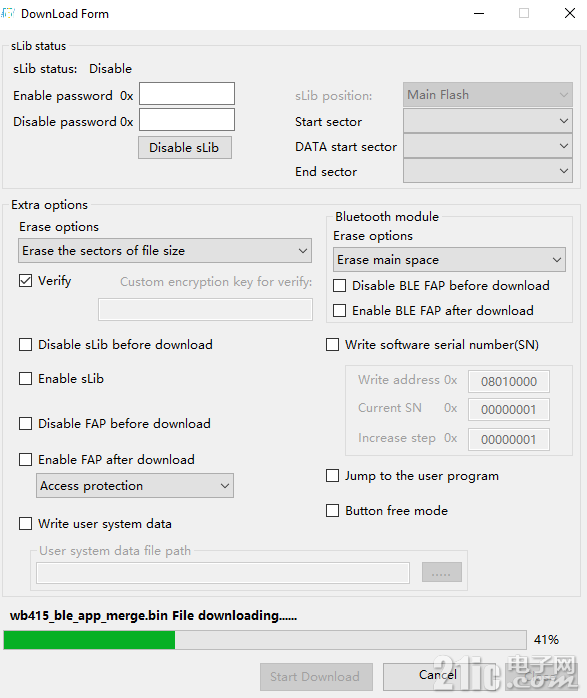

这个代码可以也用ICP Programmer写入,写入地址0x08000000,这时的蓝牙栈同时写入。
开始下载,

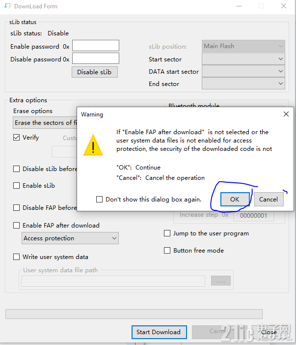

开发过程先忽略用户区数据保护的功能,
下载成功,
这个主程序的工程已经配置为使用AT-link下载,可以直接在如下地址写入,同时继续使用蓝牙栈,这样提升了开发效率。

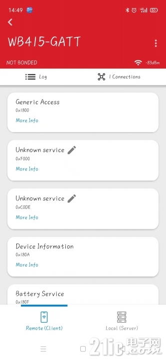

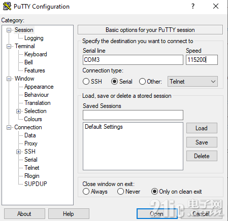

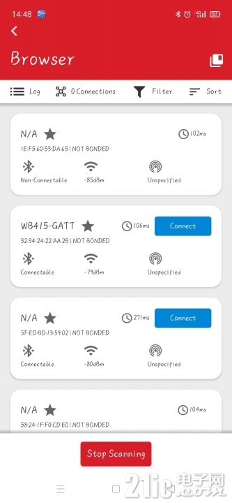

5、代码运行
开发板上有BLE reset和MCU reset,以及USER用户键,重新启动开发板,初始化后,连接串口115200-8-1-N
同时在手机端可以发现WB415-GATT的蓝牙设备
连接成功。
2039215184.jpg 蓝牙创建连接成功Pass。
