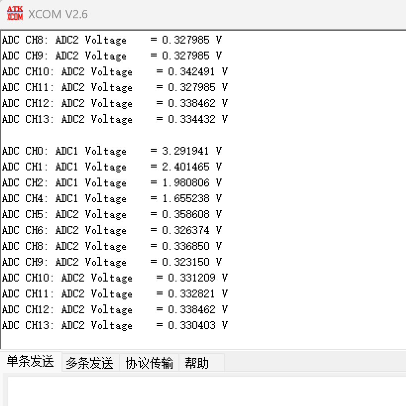

最后可以使用串口打印,输出采的电压。
  1. int main(void)
  3.     USART_Config_T usartConfigStruct;
  4.     /* USART configuration */
  5.     USART_ConfigStructInit(&usartConfigStruct);
  6.     usartConfigStruct.baudRate      = 115200;
  7.     usartConfigStruct.mode          = USART_MODE_TX_RX;
  8.     usartConfigStruct.parity        = USART_PARITY_NONE;
  9.     usartConfigStruct.stopBits      = USART_STOP_BIT_1;
  10.     usartConfigStruct.wordLength    = USART_WORD_LEN_8B;
  11.     usartConfigStruct.hardwareFlow  = USART_HARDWARE_FLOW_NONE;
  12.     APM_MINI_LEDInit(LED2);
  13.     /* COM1 init*/
  14.     APM_MINI_COMInit(COM1, &usartConfigStruct);
  15.     DMA_Init((uint32_t*)DMA_DualConvertedValue);
  16.     ADC_Init();
  17.     while (1)
  18.     {
  19.       Delay(0x1FFFFF);
  20.             printf("\r\nADC CH0: ADC1 Voltage    = %f V \r\n", ADC1_CH0_ConvertedValue);
  21.             printf("ADC CH1: ADC1 Voltage    = %f V \r\n", ADC1_CH1_ConvertedValue);
  22.             printf("ADC CH2: ADC1 Voltage    = %f V \r\n", ADC1_CH2_ConvertedValue);
  23.             printf("ADC CH4: ADC1 Voltage    = %f V \r\n", ADC1_CH4_ConvertedValue);
  24.
  25.             printf("ADC CH5: ADC2 Voltage    = %f V \r\n", ADC2_CH5_ConvertedValue);
  26.             printf("ADC CH6: ADC2 Voltage    = %f V \r\n", ADC2_CH6_ConvertedValue);
  27.             printf("ADC CH8: ADC2 Voltage    = %f V \r\n", ADC2_CH8_ConvertedValue);
  28.             printf("ADC CH9: ADC2 Voltage    = %f V \r\n", ADC2_CH9_ConvertedValue);
  29.
  30.                               printf("ADC CH10: ADC2 Voltage    = %f V \r\n", ADC3_CH10_ConvertedValue);
  31.             printf("ADC CH11: ADC2 Voltage    = %f V \r\n", ADC3_CH11_ConvertedValue);
  32.             printf("ADC CH12: ADC2 Voltage    = %f V \r\n", ADC3_CH12_ConvertedValue);

将PA0接到高电平,查看串口打印的就是正确的了。

之前我们用极海的407有发生采样不准的情况,你有没有碰到啊?
 楼主| Alden 发表于 2025-7-18 11:14 | 显示全部楼层
注意电源的纹波和稳定性,注意ADC的时钟频率,没分频跑在超频的状态精度会受很大影响,正常测试精度是没问题的

 楼主| Alden 发表于 2025-7-29 14:17 | 显示全部楼层
目前测试精度是没问题的,也可以排查VDDA/VREF的供电纹波情况,ADC时钟配置是否在36M以下,是否有开ADC校准,采样的电压输出能力比较弱需要将ADC采样周期加大。
