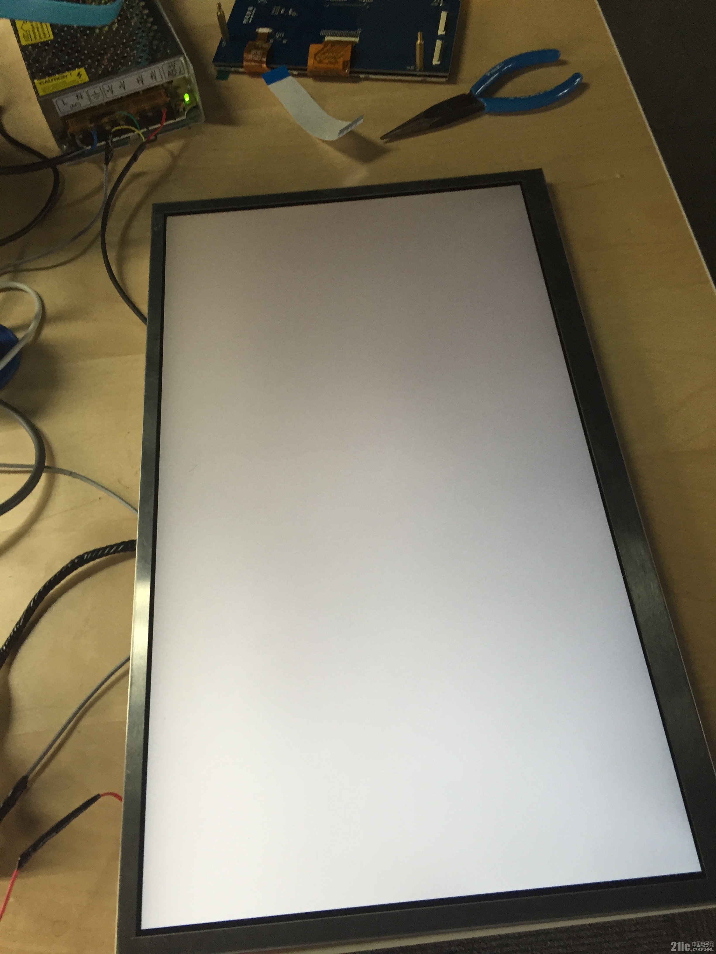

大家好,我最近在明远智睿的开发板上调试lcd屏幕,使用的是android4.4.2版本,当我把屏参数配置好以及uboot参数配置好后,启动屏幕,屏幕无**常显示,一片白。请问这是什么原因??????
我的uboot参数:setenv bootargs console=ttymxc0,115200 init=/init video=mxcfb0:dev=ldb,LDB-1080P60,bpp=32  ldb=spl1 video=mxcfb1:off video=mxcfb2:off fbmem=30M fb0base=0x27b00000 vmalloc=400M androidboot.console=ttymxc0 androidboot.hardware=freescale

首先你要确认你的uboot参数是否设置OK,还有你这里还可以通过串口终端打印的信息看是否有什么异常。
你这里使用他们的开发板和屏,参数设置OK的话,起来应该没有什么问题的。

版主你好,uboot参数是明远智睿FAE给我的,然后串口打印信息一切正常,并没有报错什么的,但是现在就是无**常显示,很奇怪啊,  lvds线会有影响吗,我是用fpc转正常线的转接板弄的

线不是他们提供给你的吗?
FSL_TICS_Rita 发表于 2015-9-21 17:24 | 显示全部楼层
你试一下 ldb=spl0改成这个看好使不?

不行啊  , 还是那样  。。线会有影响吗

我们换了一个新的屏幕,lvds线是我自己做的, 线的接法是不能有问题的,我对了好几遍

         "LDB-1080P60", 60, 1920, 1080, 13351,
         40, 40,
         30, 20,
         10, 10,
         0,
         FB_VMODE_NONINTERLACED,
         FB_MODE_IS_DETAILED,},
这个是我屏幕参数的配置,屏幕手册在附件,屏幕参数截图

这样,你看一下论坛中我之前发的帖子:
https://bbs.21ic.com/icview-808994-1-1.html
希望对你有一些启发。

Please get the attached “dual_1080p_display_demo.pdf” about i.MX6 android dual display hardware demo, it also include dual-channel LVDS cable connection.
For related software solution about Android4.2 dual display, you can refer to “How to Enable Second Display Showing Different Things on JB4.2.2 SabreSD”:
https://community.freescale.com/docs/DOC-94354
The attached Files are a layout xml file, a patch and a recorded video.
The layout file should be put into android/frameworks/base/packages/SystemUI/res/layout/ folder.
The patch should be applied to frameworks/base.git.
The recorded video shows the dual display demo as a reference.
You can get more detailed information about Android4.2 secondary display from the following website:
http://developer.android.com/about/versions/android-4.2.html
and you can get information about related “Class Presentation” from the following website:
http://developer.android.com/ref ... p/Presentation.html
Some addition, please set proper Uboot environment as following:
U-Boot > setenv bootcmd booti mmc3
U-Boot > setenv bootargs console=ttymxc0,115200 androidboot.console=ttymxc0 vmalloc=400M init=/init video=mxcfb0:dev=ldb,bpp=32 video=mxcfb1:dev=hdmi,1920x1080M@60,bpp=32 video=mxcfb2:off fbmem=10M androidboot.hardware=freescale
U-Boot > saveenv
