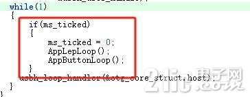

实现按键点击和长按的识别,这里使用1ms的定时器对按键按下状态计数实现去抖和单击长按的识别,在主循环中ms_ticked == 1时调用AppButtonLoop()并重新将ms_ticked 置0
  1. void wk_tmr6_init(void)
  3.     crm_periph_clock_enable(CRM_TMR6_PERIPH_CLOCK, TRUE);
  4.     tmr_base_init(TMR6, 999, 215);
  5.     tmr_cnt_dir_set(TMR6, TMR_COUNT_UP);
  6.     tmr_period_buffer_enable(TMR6, FALSE);
  7.     /* configure primary mode settings */
  8.     tmr_primary_mode_select(TMR6, TMR_PRIMARY_SEL_RESET);
  9.     /* configure overflow event */
  10.     tmr_overflow_request_source_set(TMR6, TRUE);
  11.     tmr_counter_enable(TMR6, TRUE);
  12.     /* add user code begin tmr6_init 2 */
  13.     tmr_interrupt_enable(TMR6,TMR_OVF_INT,TRUE);
  14.     /* add user code end tmr6_init 2 */
  15.     nvic_irq_enable(TMR6_GLOBAL_IRQn, 0, 0);
  16. }
  17. uint8_t ms_ticked = 0;
  18. uint16_t led_conut = 0;
  19. void AppLepLoop()
  20. {
  21.     if(led_conut > 0)
  22.         led_conut -= 1;
  23.     if(led_conut == 0)
  24.     {
  25.         led_conut = 1000;
  26.         at32_led_toggle(LED2);
  27.         at32_led_toggle(LED3);
  28.         at32_led_toggle(LED4);
  29.     }
  30. }
  31. uint16_t button_down_count = 0;
  32. void AppButtonLoop()
  33. {
  34.     if(at32_button_state() != RESET)
  35.     {
  36.         button_down_count += 1;
  37.     }
  38.     else
  39.     {
  40.         if(button_down_count > 20 && button_down_count < 500)
  41.         {
  42.             USBH_DEBUG("button clicked");
  43.             yuyy_button_clicked();
  44.         }
  45.         button_down_count = 0;
  46.     }
  47.     if(button_down_count == 1000)
  48.     {
  49.         USBH_DEBUG("button long press");
  50.         yuyy_button_longpressed();
  51.     }
  52. }
  53. void AppMsTick(void)
  54. {
  55.     ms_ticked = 1;
  56. }

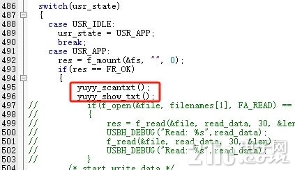

实现U盘中TXT文件的扫描
  1. #define MAX_TXT_NUM 10
  2. char filenames[MAX_TXT_NUM][14];
  3. uint8_t txt_num = 0;
  4. void yuyy_scantxt()
  5. {
  6.     uint8_t len,i;
  7.     FRESULT res;
  8.         FILINFO fileinfo;
  9.         DIR dir;
  10.     res=f_opendir(&dir,"/");
  11.     if(res != FR_OK)
  12.         return;
  13.     memset(filenames,0,MAX_TXT_NUM*14);
  14.     txt_num = 0;
  15.     while(1)
  16.     {
  17.         char* pstr;
  18.         res = f_readdir(&dir, &fileinfo);
  19.         if (res != FR_OK || fileinfo.fname[0] == 0 || txt_num == MAX_TXT_NUM)
  20.             break;
  21.         if(fileinfo.fattrib&AM_DIR)
  22.             continue;
  23.         len = strlen(fileinfo.fname);
  24.         if(len > 4 && memcmp(&fileinfo.fname[len-4],".TXT",4) == 0)
  25.             memcpy(filenames[txt_num++],fileinfo.fname,13);
  26.     }
  27.     i = 0;
  28.     while(i < txt_num)
  29.     {
  30.         USBH_DEBUG("%d: %s",i,filenames[i]);
  31.         i++;
  32.     }
  33. }
显示文件列表和文件内容

在usbh_user_application()中case USR_APP分支中注释掉原来的读写文件方法,加入yuyy_scantxt();和 yuyy_show_txt();
